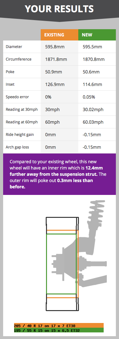

With a 195/55R15" tire it will be circumference wise the same size as the 205/40R17" tires, and it would fit perfectly in that perspective.

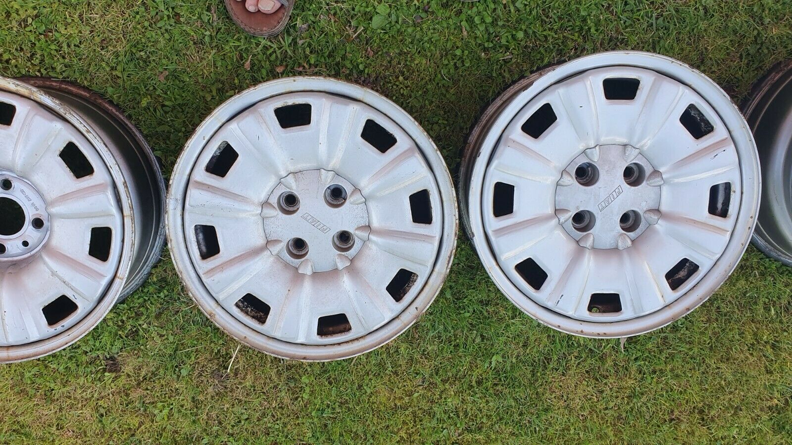

sorry for bumping up this old thread....but has anyboday experience with the Barchetta steelies (6.5x15 ET32) on a 595 with the standard brakes? Does this work without spacers?
https://www.bielstein.com/media/image/product/18240/md/wheel-steel-oe-barchetta.jpg
Thanks
I think they will work, enough space behind them, because of the flat wheel face.
They also fit on the old Panda 100hp, and that have/had so far i know the some brakes als the standard Abarth brakes. (correct me if i'm wrong)

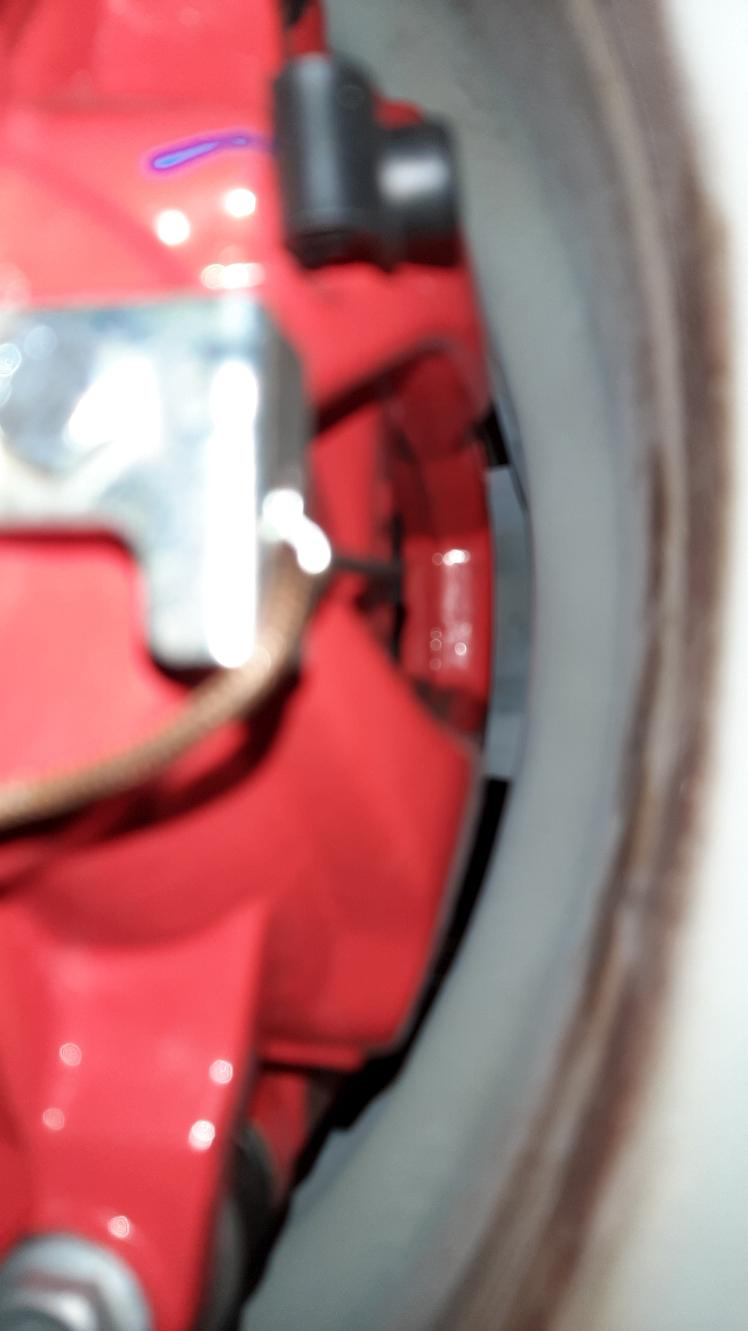

Brembo brake kit is quite demanding about wheels if I may say.
It needs 17" but not everyone fit without spacers.
I have these Competizione wheels for winters and they need 10mm spacers to front (stock brakes in that pic still).

I already have the Barchetta wheels, but the car will be delivered in September. So before painting them white, I want to know if they fit...

Yes I´m now also quite confident that this will fit without any problems, due to the flat wheel disc design. There is around 340mm in Diameter und 50mm in hight, measured from the mountig surface.

Yes, I can confirm now, they fit perfectly.:)
