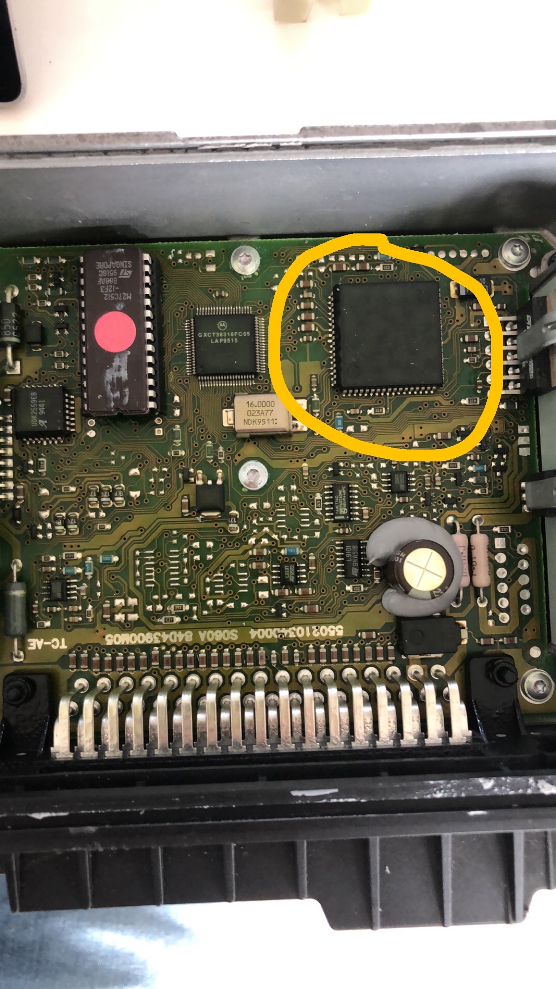

Unfortunately the ECU has an IMO and I have the key but not the matching control box.
ECU is: IAW 8F .5T
I do have an EEPROM programmer (TL866II), which I've tried to use to remove the immobiliser. But after further research and failed attempts, it looks like the immo is set in the Motorolla HC11 chip.
Is this correct? (I have a UPA programmer for the HC11 on it's way from overseas)
Has anyone else done this themselves?
Am I correct in thinking the immo off bin file should be pulled from the HC11 chip circled in yellow not the eeprom (red / pink circle).

Yes, you do need a USB - UPA programmer to read the HC11F1 chip circled above (where the IMMO bin file is located). I removed it from my first ECU with a heat gun, but might have destroyed the board in the process. (the chip was fine just something else went pop on the board as I didn't contain the heat properly)

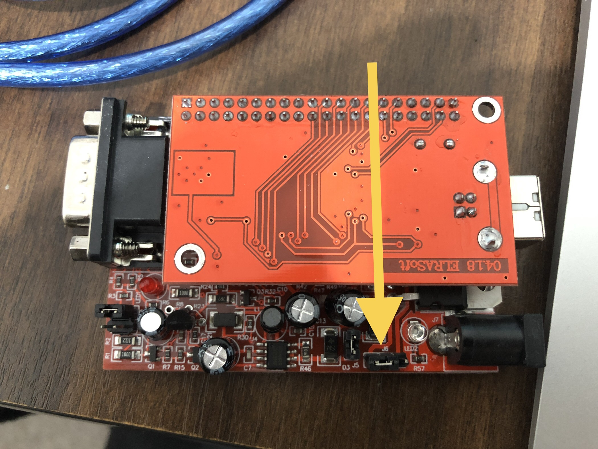

Anyway, I put the HC11F1 chip into the 68PLCC adaptor my UPA-USB came with. It didn't read.... After freaking out and reading a bit (as it was a Chinese clone) I realised the reader got shipped to me with the switch on the DC voltage setting not the USB setting. Shown with yellow arrow is the dc setting. Just lift the pin joiner and move across.
So it read the chip perfectly, I saved the 512kb bin file as Factory settings, made a copy, and uploaded that onto the immo off program I had. Ran the program and it was a success.

I've done it! Finally found solution for wiring up the IAW 8f 5t ECU to the UPA USB programmer (used a china clone), without having to desolder the Motorola HC11F1 chip!
See attached what I did,
I also took a video which I'll edit and put up on youtube for step by step. Just wanted to make sure my car started after uploading the modified file first! (It did :) )
this guide might work on other IAW ECU's obviously use at your own risk.
