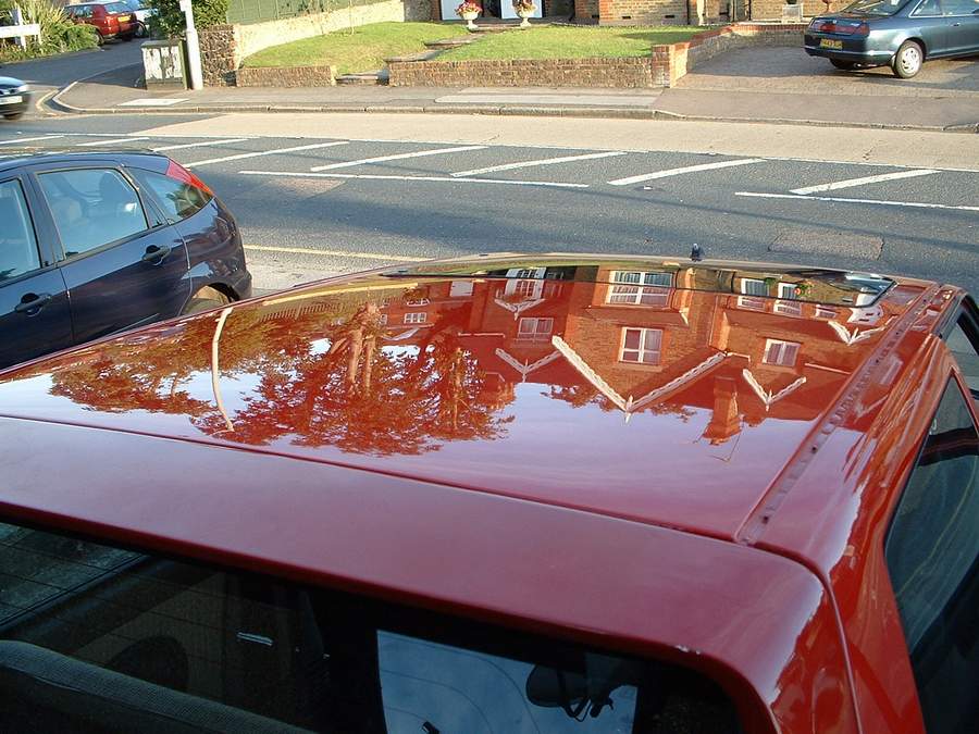

I've attached a picture of my 19 year old Uno roof after what amounted to a days work. The paint had really badly oxidised, so much so that it was completely matt. T-Cut on it's own didn't have much effect, so drastic action was required. Two going overs with Turtle Wax rubbing compound got rid of most of the oxidisation. Then I gave it two going overs with T-Cut, and this time the paint came up really nice. Both these are good for developing arm muscles!
Then I used Turtle Wax High Gloss polish. I just happend to have a some lying around, I don't know if it's even still available. I gave it one coat, then a good buffing by hand. Then I gave it a second coat and used an electric buffing machine.
Then end results look pretty good I think, especially considering it's the original paint put on in 1986!
Bloody hard work though, and now I have the rest of the car to do :( Gonna take ages, but it should look nice when it's done :)

Did a good job there (y) I had to use rubbing compound to bring my paintwork back to life - but only had the roof, bonnet and rear hatch to do as i resprayed the sides of the car ;)
EDIT: And an important point i would like to point out to others - you can only really cut the oxidised paint off with rubbing compound once - twice if you do it very cautiously, otherwise you'll end up taking all the colour off and be left with the white primer coat :(

Thanks for the kind words everyone! It was very hard work to get the roof looking like that, but I think the end result was worth it.

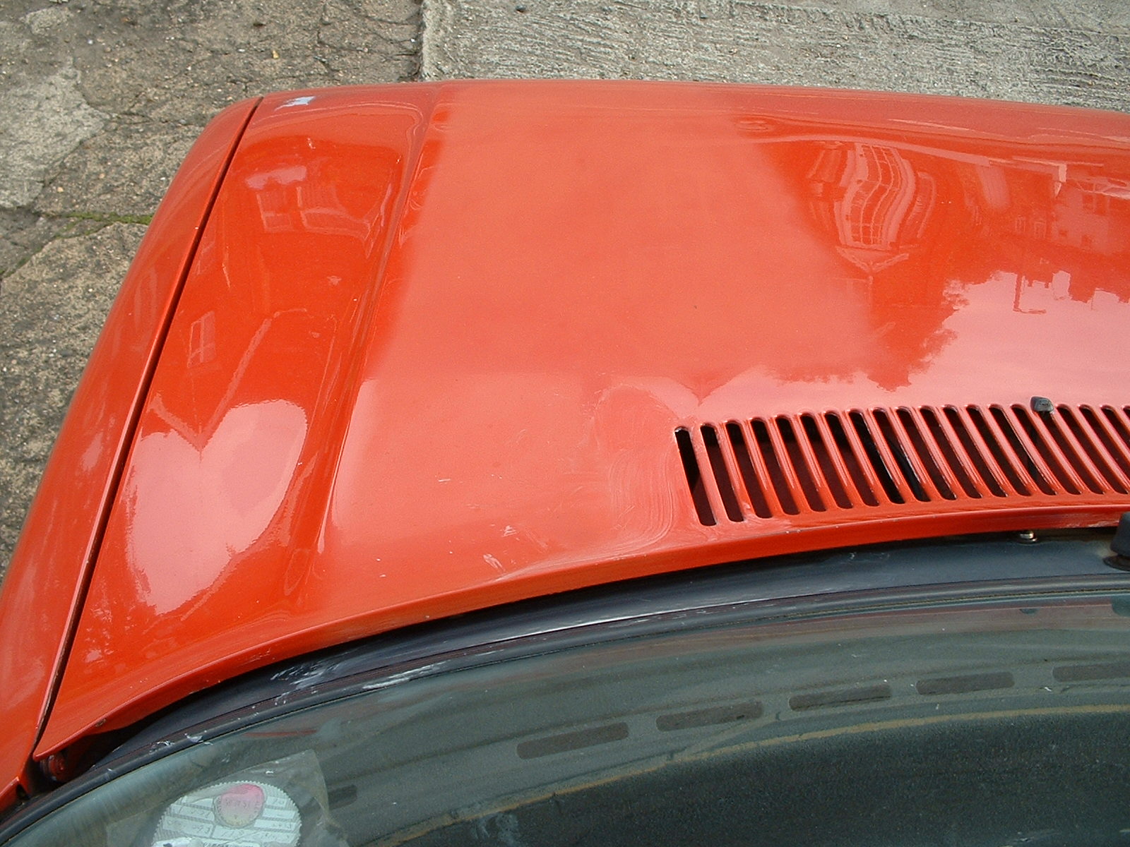

Red is a notorious colour for fading and oxidising, so it remains to be seen how long mine will keep it's shine. Then again, I did the same for most of my bonnet a year ago and it seems to have held up pretty well. I've attached a picture so you can see what it looks like, plus also you can still see the strip of oxidised paint that I've still yet to polish up. The oxidised paint you can see is what pretty much covered the whole of my car. Also attached is the bucket of water I was using for rinsing the cloth, and you can see quite clearly how much paint and oxidisation came off in the process :eek:
