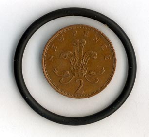

Look what turned up when I went to cancel my order (attached). The O ring Gasket from my local dealer.
Turns out FIAT have changed the minimum order and they now have to order 22 (of these)– but can now return any unwanted
:( I’m thinking of complaining to in writing FIAT Auto UK LTD. How long did it take them?
Ill Soon have one spare lol.

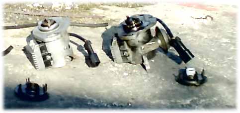

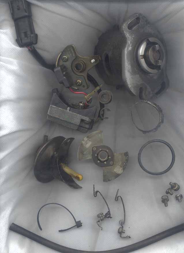

;)This is the brakerless FIRE Distributor in bits. Look at the old O Ring gasket :( in 2 pieces. – new one fitted.
The shaft seal it intact as no trace of oil from there lol.

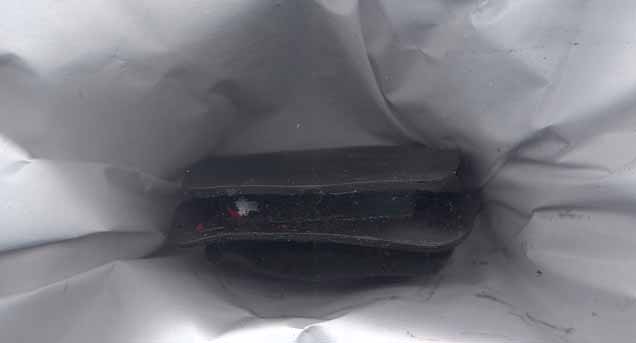

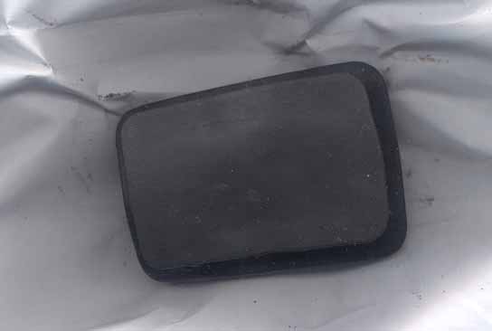

I forgot to mention I fitted a new timing inspection hole cover some time ago (Old is attached). The leaking oil was just missing the hole, but this has not always been the case – look how the old one is perished and covered in oil. I guess the old owners normally parked on a different camber / hill.
Its funny how a couple of rubber seals replaced in time saves Many £££.
Alex, how do you get to the shaft oil seal? ;) Also see inverted link . Do you reckon anything will spring out? Thanks in advance for any help!

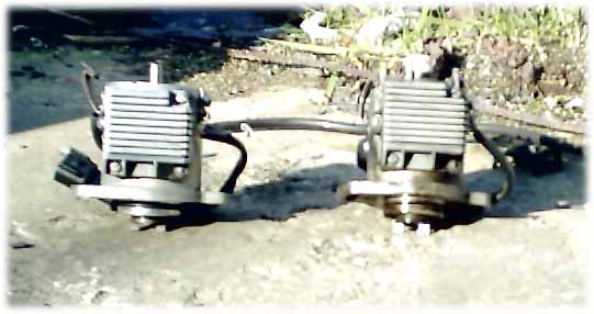

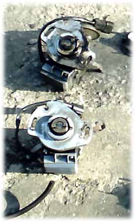

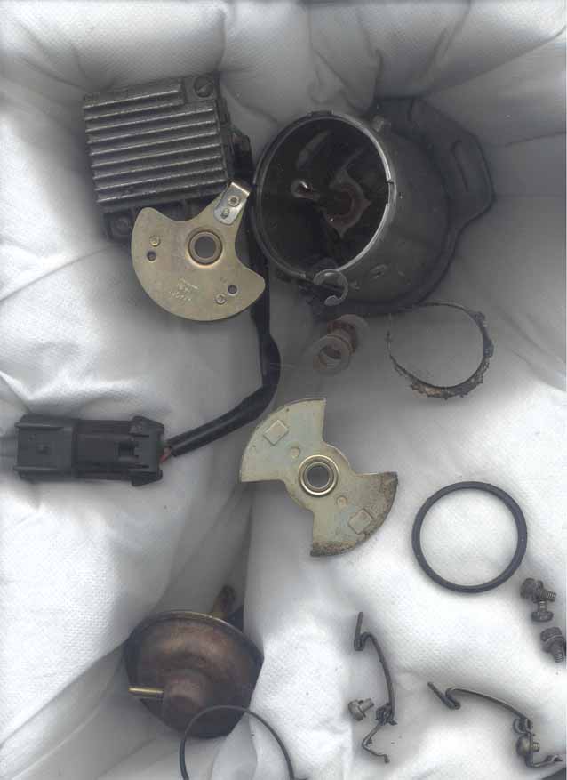

I've successfully replaced my distributor (y) , keeping only my working vacuum advance. So far I only replaced the O-ring gasket, still a little head scratching on the shaft oil seal lol. The oil seal is OK on the substitute distributor for now.
What has really puzzled me is the working vacuum advance unit its self was full of oil! Can anyone tell me if this is normal :confused: As the Diaphragm is not leaking I reckon there is only one way in – from the other end of the vacuum pipe. The old pipe also had oil in it???
;) Nearly rebuilt distributor pick attached – too dark to take pick as no flash lol. After a short test-drive no oil leak – and more top end although ECU is only partly reset…
:D Ill put new NKG BCPR6eS plugs (for IE) in tomorrow and try 0.95 MM gap – Should be between 0.85 – 0.95 according to all sauces other than Haynes… dam Did I fitted Champion last time.
New air filter breather pipe and hot air intake pipe as well as new air filter... I’ll then check timing. – or should I fit my Induction…

Re: Oil in Vacuum advance?
Louie,
Sorry I've been away for a few days (OK, I suppose I've still been here, but too busy with a new job at an electronics shop) AND I'm a bit sick at the moment :dead:
To take the shaft out of the distributor, remove the keyring-shaped spring rings from around the drive dog (yes that really is the technical name for it). This lets you push out the pin that holds the drive dog to the shaft. It would be a good idea to mark the drive dog so that you refit it the correct way around (or take some more pics). You wouldn't want it to be 180-degrees out!
Grasp the distributor body and tap the distributor shaft (the end that had the drive dog) on a hard surface and, from memory, I think it will push the seal out of the housing. So, an easy job, and I bet that the old seal will be rock-hard compared with the new... that is, if you've managed to get the new one yet?
I tried to get a new seal from a bearings/oil seals supplier, and that failed because of it being a very odd size. So, I think you will have to venture back to the FIAT dealer...
