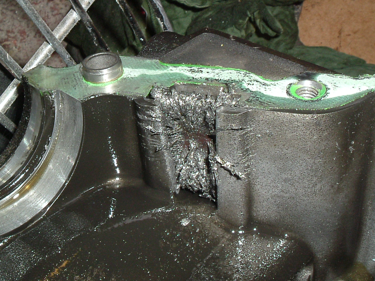

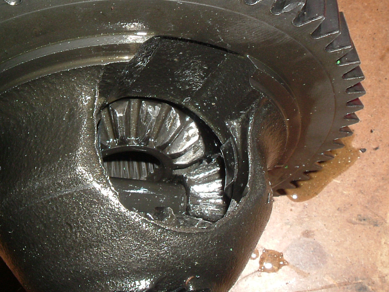

Bad News,

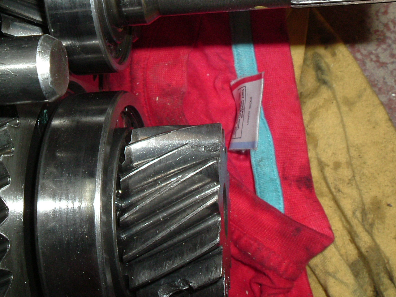

Somethings broken up inside the gear box and has burst the bell housing. Most of whatever it was seems to have been chewed up by the differential which is in a pretty bad state. One of the other gears has some nasty chips out of some of the teeth.
Hope I can find a new gearbox in the breakers, otherwise I sense an expensive repair coming on.

Do you know what went wrong? i.e. what caused the failure? You should try and find out just incase it happens again!

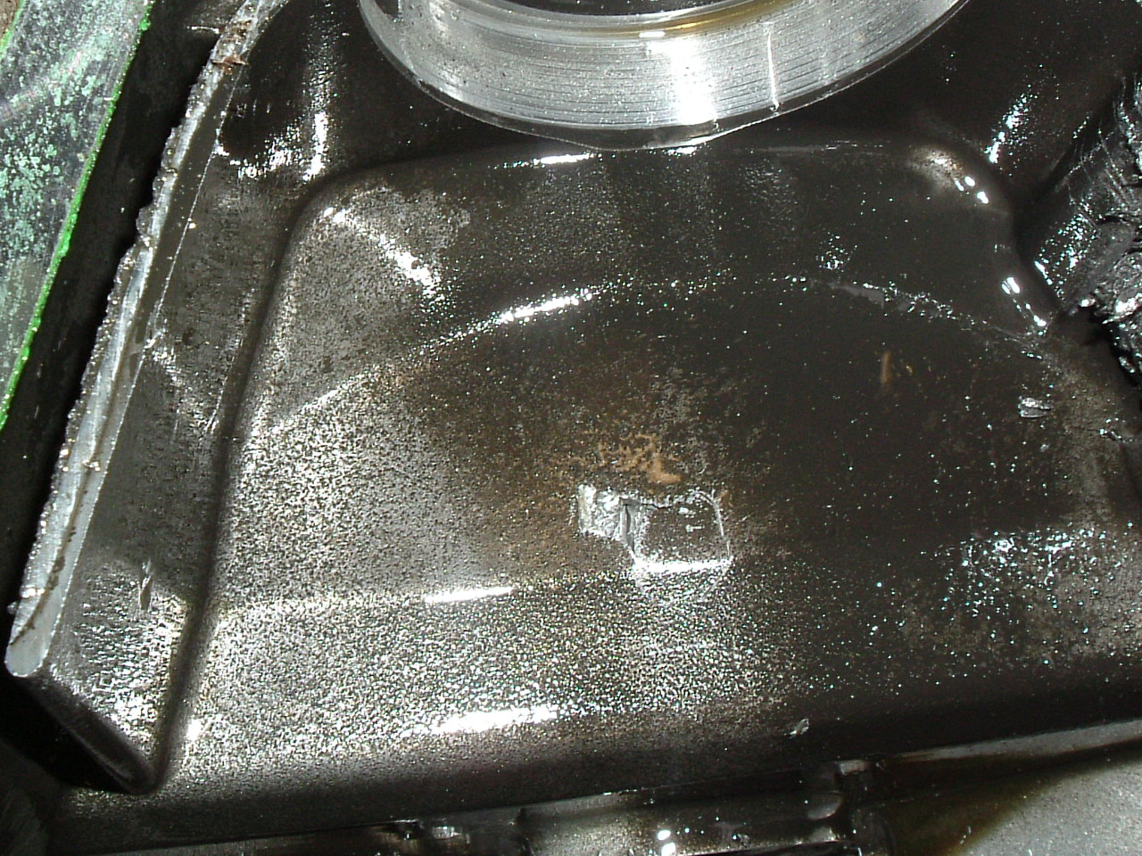

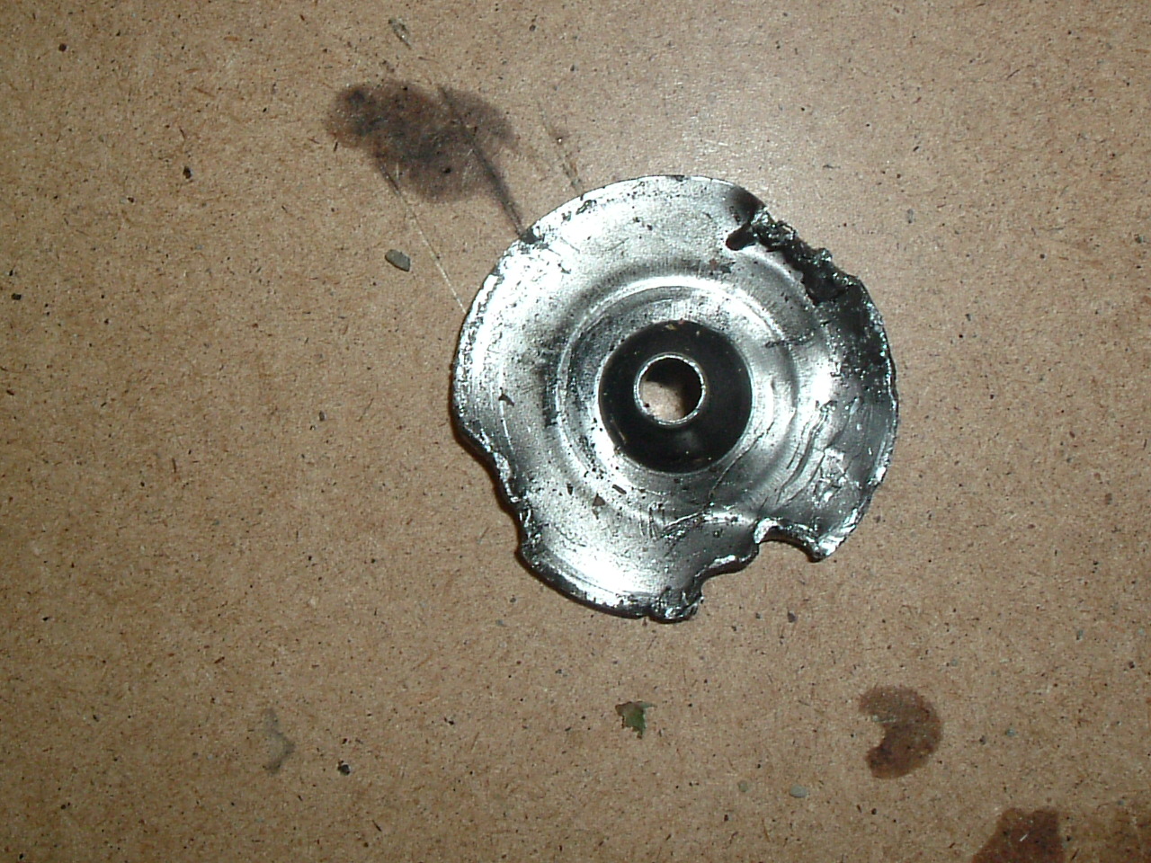

You see the big gear with the chipped tooth, well this funny shaped thing in the photo below lives at the end of that gear shaft. There was obviously something else there as well, possibly a seal or a bearing. Whatever it was was made of hard metal as all the fragments I have found are mostly hardened with some soft white metal as well.
Anyway whatever it was it broke up and was pushed by the big gear into the differential housing where it burst the clutch housing (hence the oil leak) before being chewed up by the diff.
Its a 96 1.4 Brava and I believe it wasn't uncommon with this gear box. Later versions have it sorted. Unfortunately this is a low mileage car so the fault has occurred quite late.
