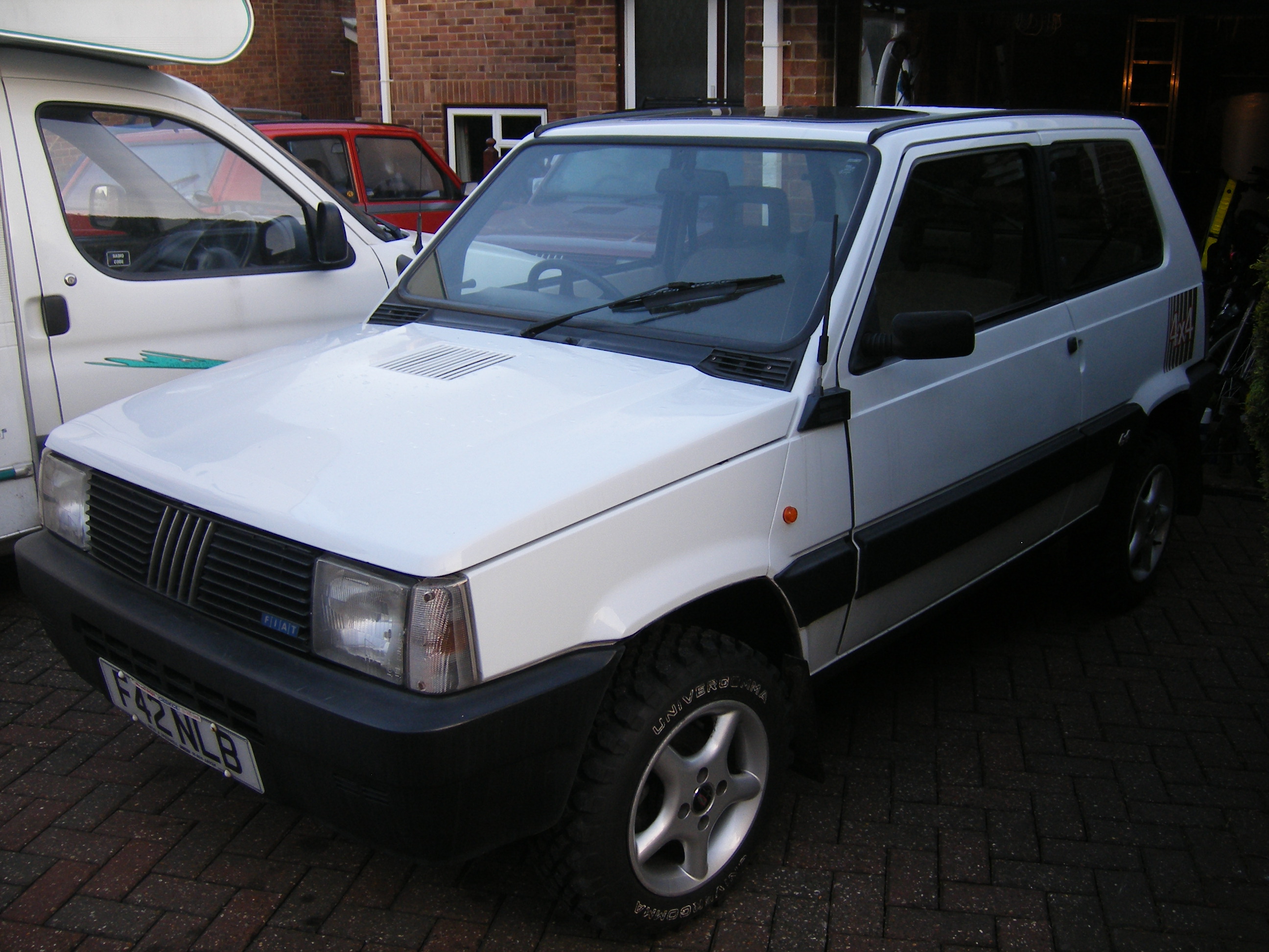

Here's a pic the day after I bought it so we all know what I'm starting from....
As you can see it's pretty good to start with, just as well as I don't have too much time to dedicate to this one.
After driving it home I felt that it was in fine condition mechanically, apart from a little pinking under load.
Interior is 99% excellent, just the plastic trims that hold the carpet at the door apertures and a cracked instrument panel screen to replace.
Bodywork is mostly rust and dent free. I can see very shallow dents in the front edge of the bonnet where people have pressed the bonnet shut instead of just dropping it :bang:, and the same thing next to the drivers door handle, also where someone has probably pushed on a half closed door. Rust is minimal at the bottom of the drivers door and should be easily saveable.
As always I started with a good clean up, followed by fitting of the alloys from the blue clx. They will be coming off again to be refurbised and have the white lettering re-done on the tyres but I was impatient to see how it looked :). Better pictures later but here's one for now.....

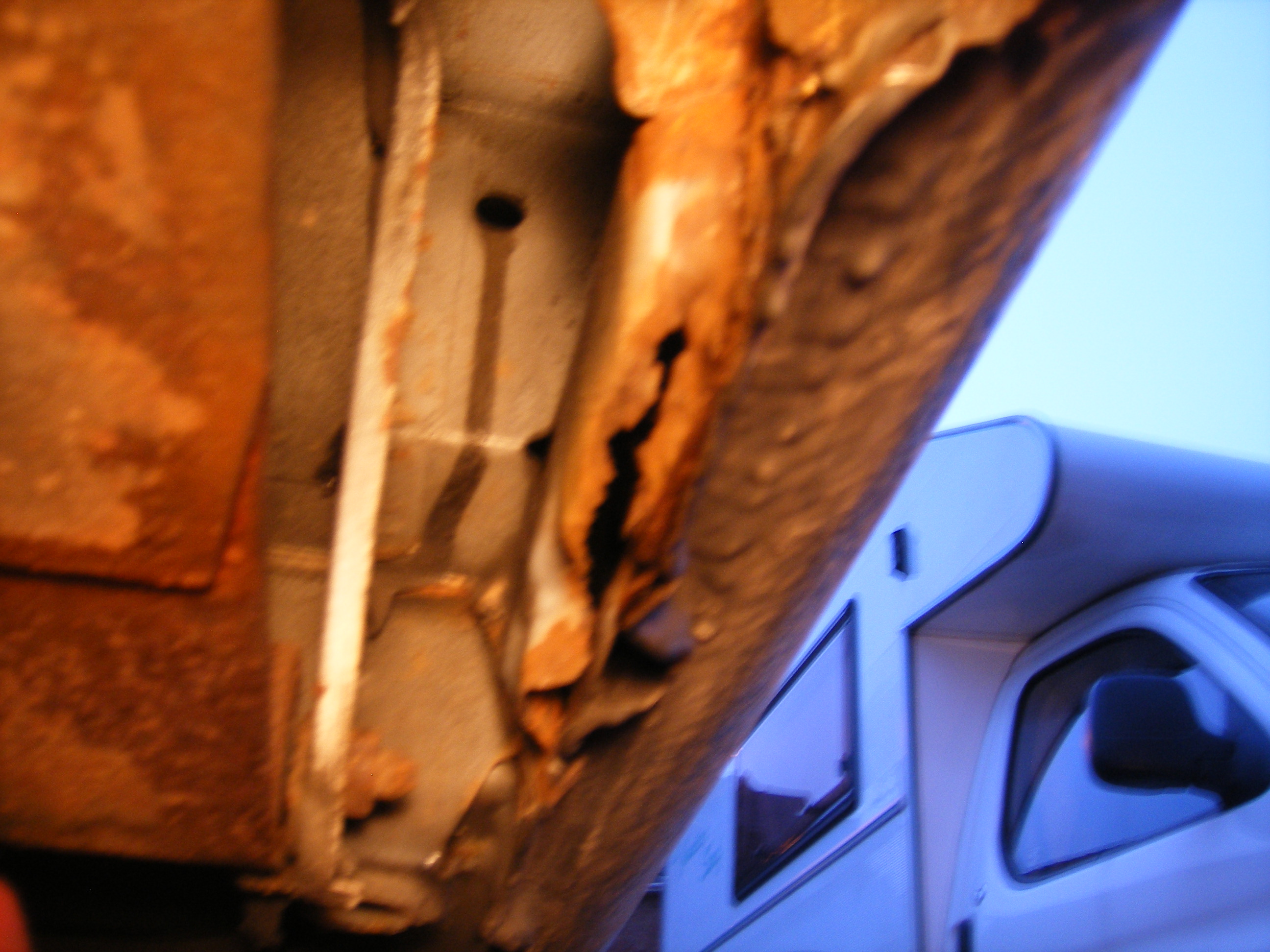

Next up was an Mot. I checked it over myself first and, sadly, found a rust hole in the inner sill, right at the back in the usual place beside the spring hanger. A bit disappointed to have found it really as the rest of the underside is spectacularly good, but it's there so I'll just have to accept that I cannot say that this one has never been welded :(.

That's it so far, I've already cut out the rust and made a repair piece which will be welded in by the garage who carried out the mot, I'm not set up for welding yet. Tomorrow I shall do the service then it's back for welding and retest early next week, just in time to tax it on 1st of March :D.
Some pics of the rusty area. I made the hole quite a bit bigger to make sure they'd be welding to very good metal. I also tried to copy the orginal body contours with the repair patch as I didn't want just a flat piece of plate slapped on there, but with no panel beating tools to speak of I have to put up with it still looking a little crude :p.

Your repair patch looks very neat too, that area seems like a common place for them to go, tricky to get in there to weld though.

Yeah, that area has needed attention on alot of the Pandas I've been through, only my blue clx and 750L are still untouched. The other side of this one is fine, just goes to show how vulnerable this area is when even on a good one it can still go.
