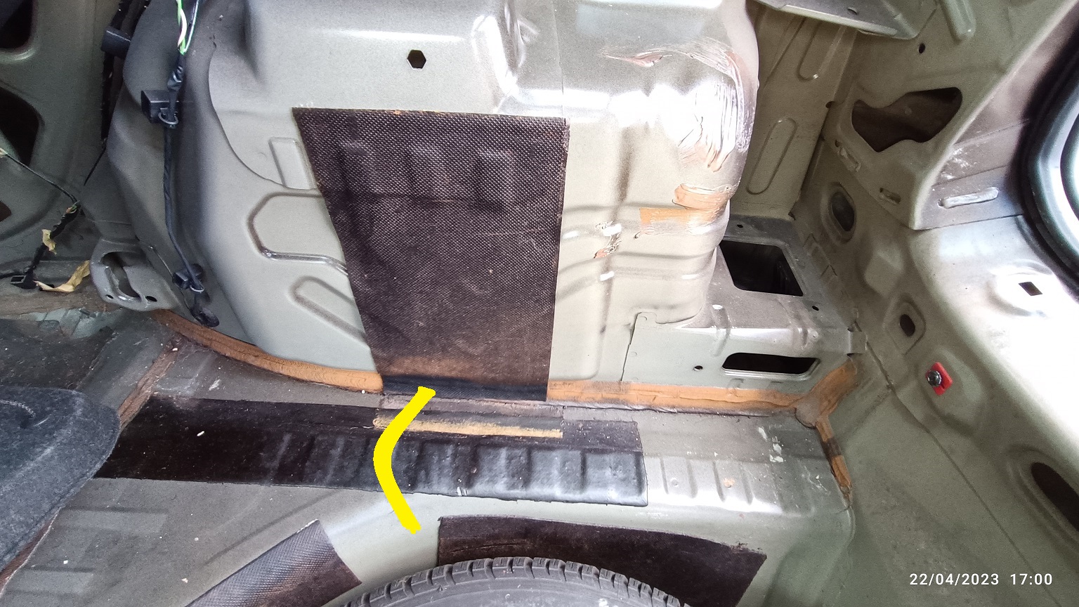

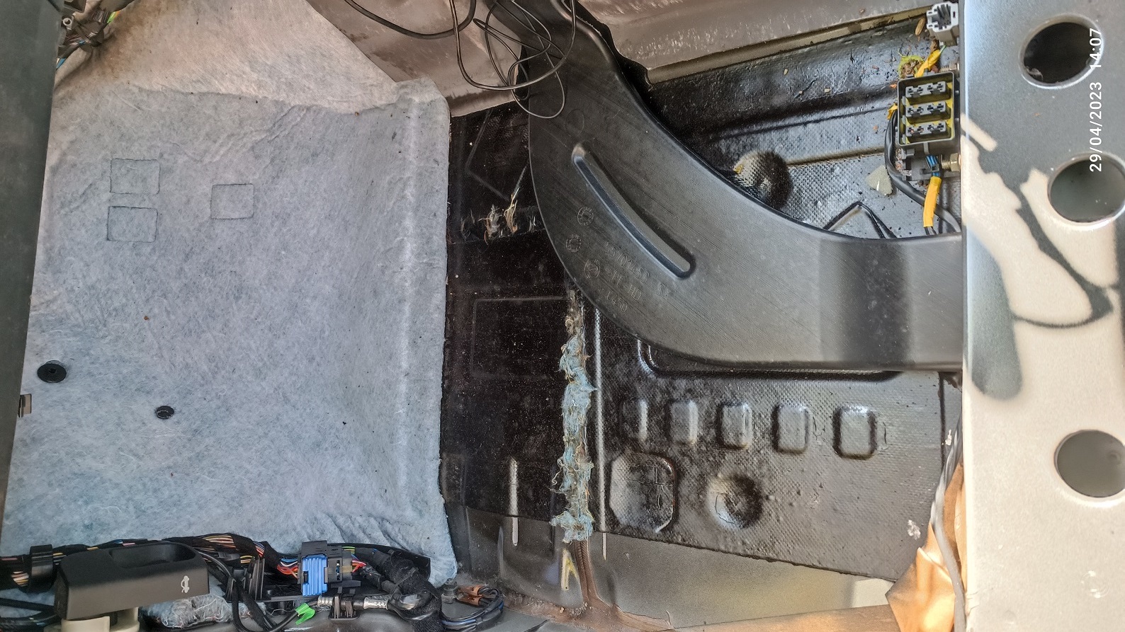

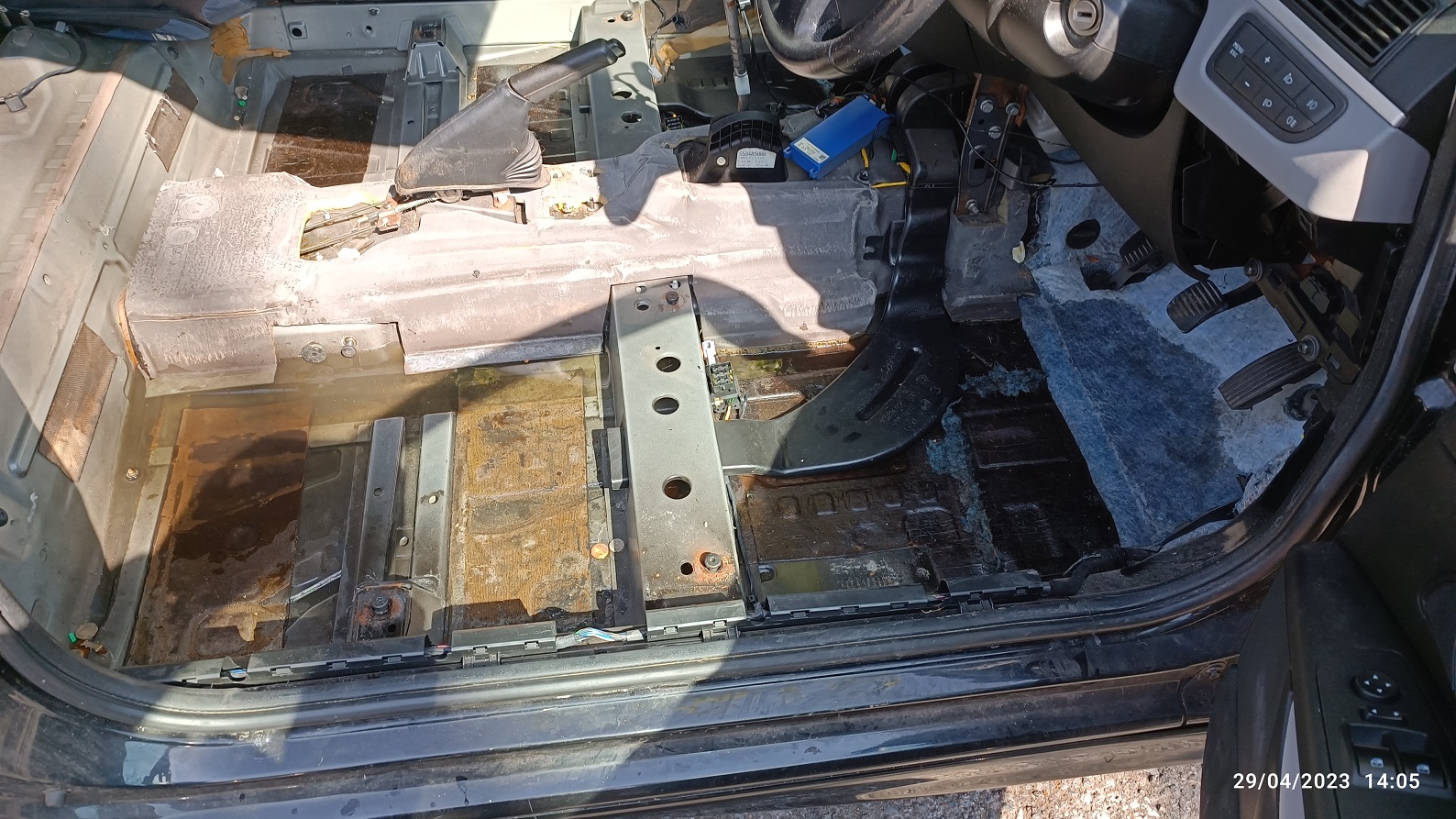

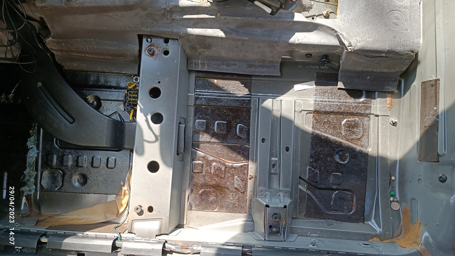

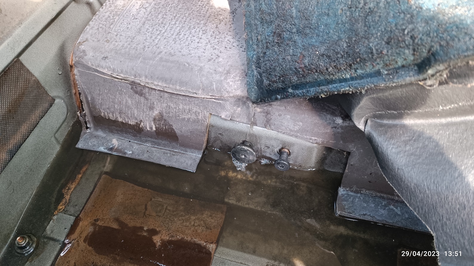

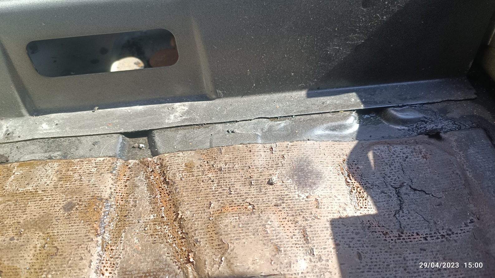

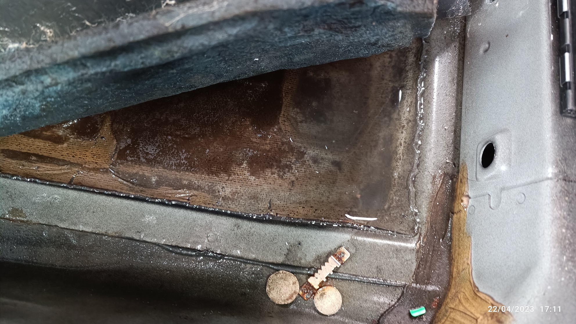

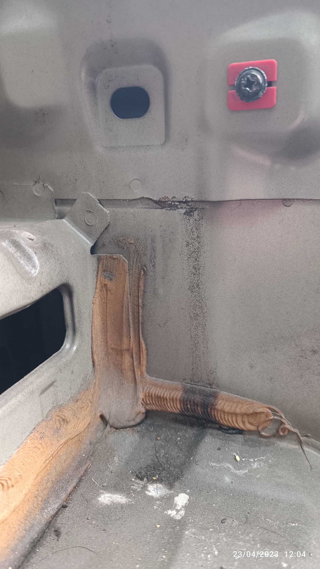

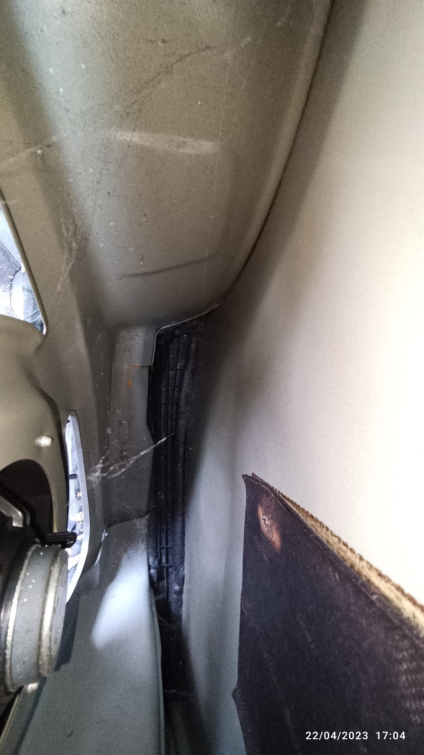

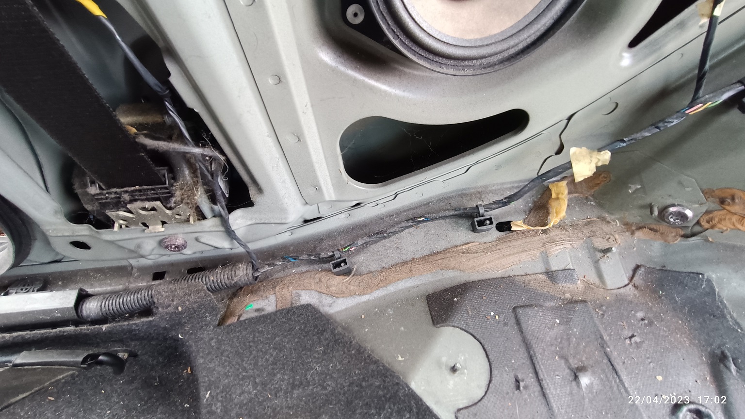

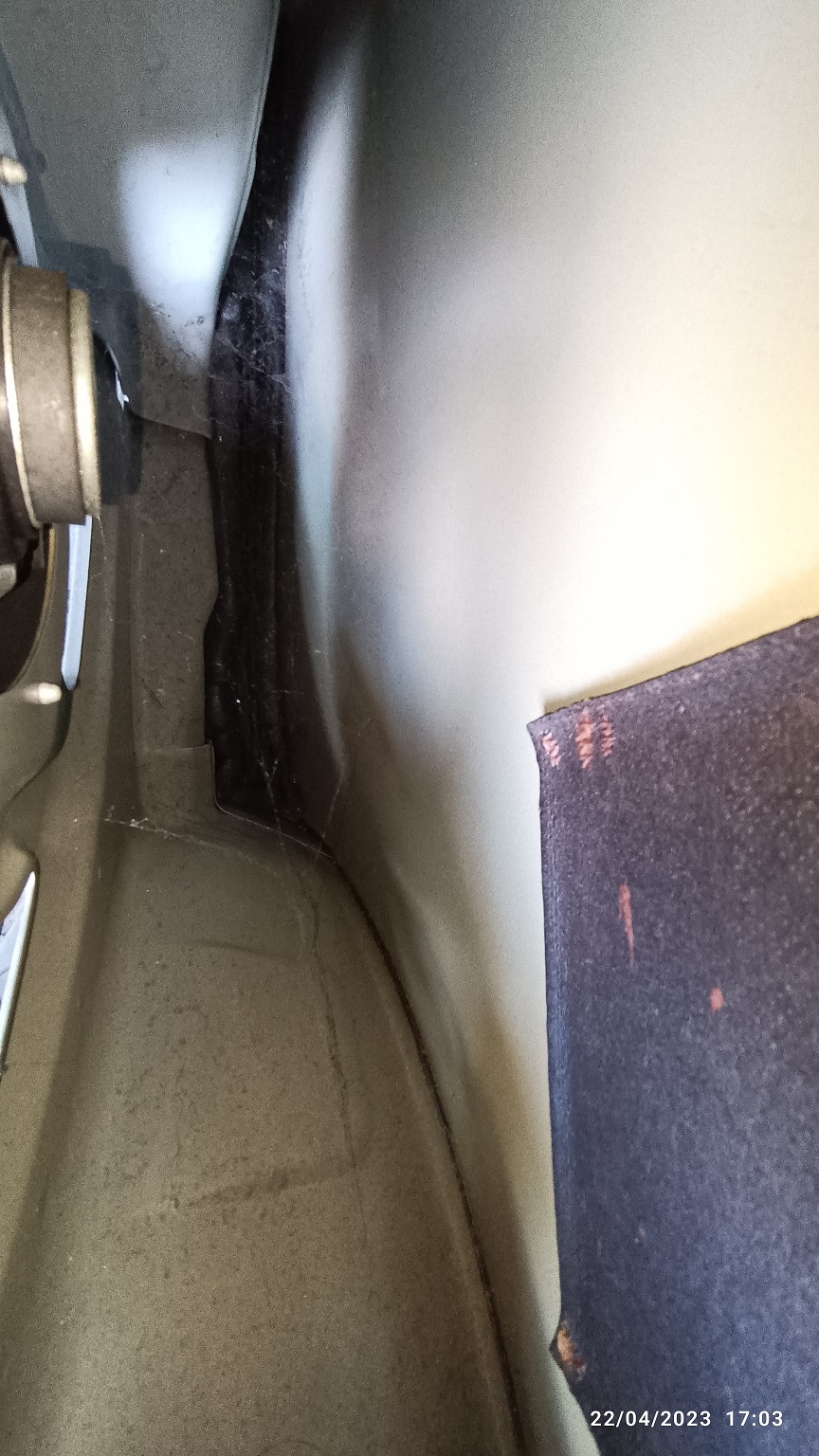

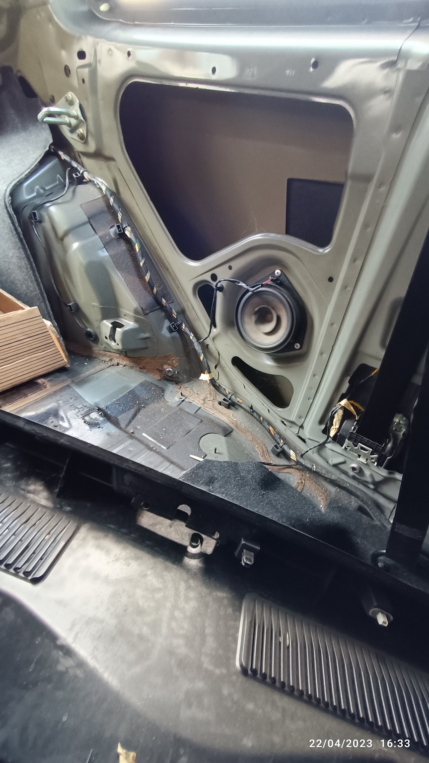

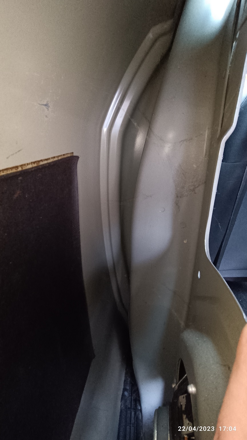

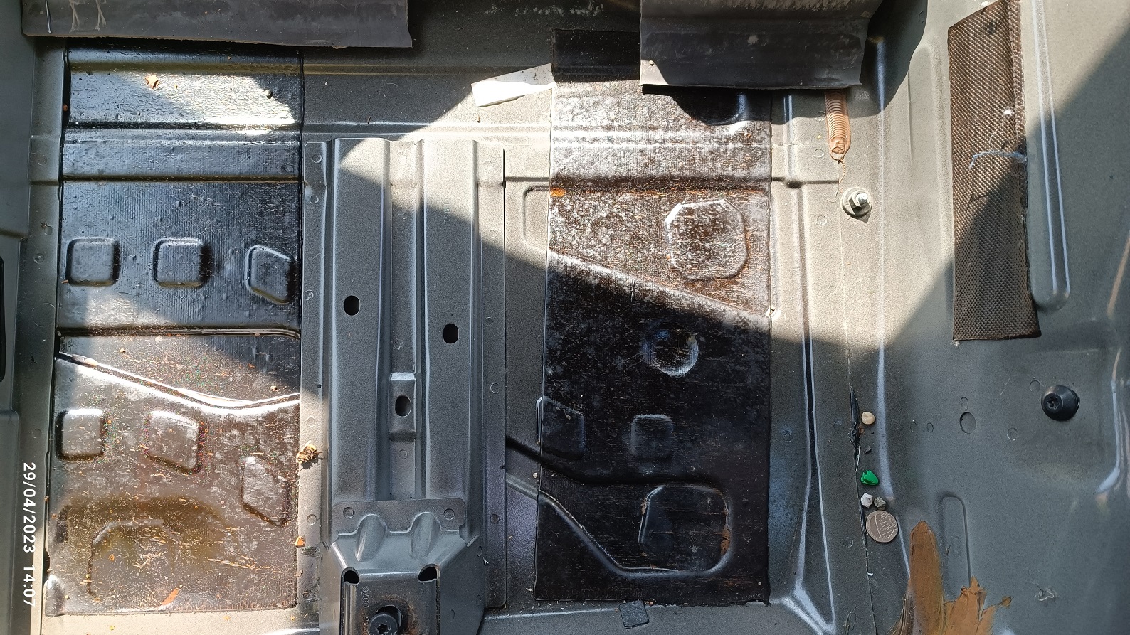

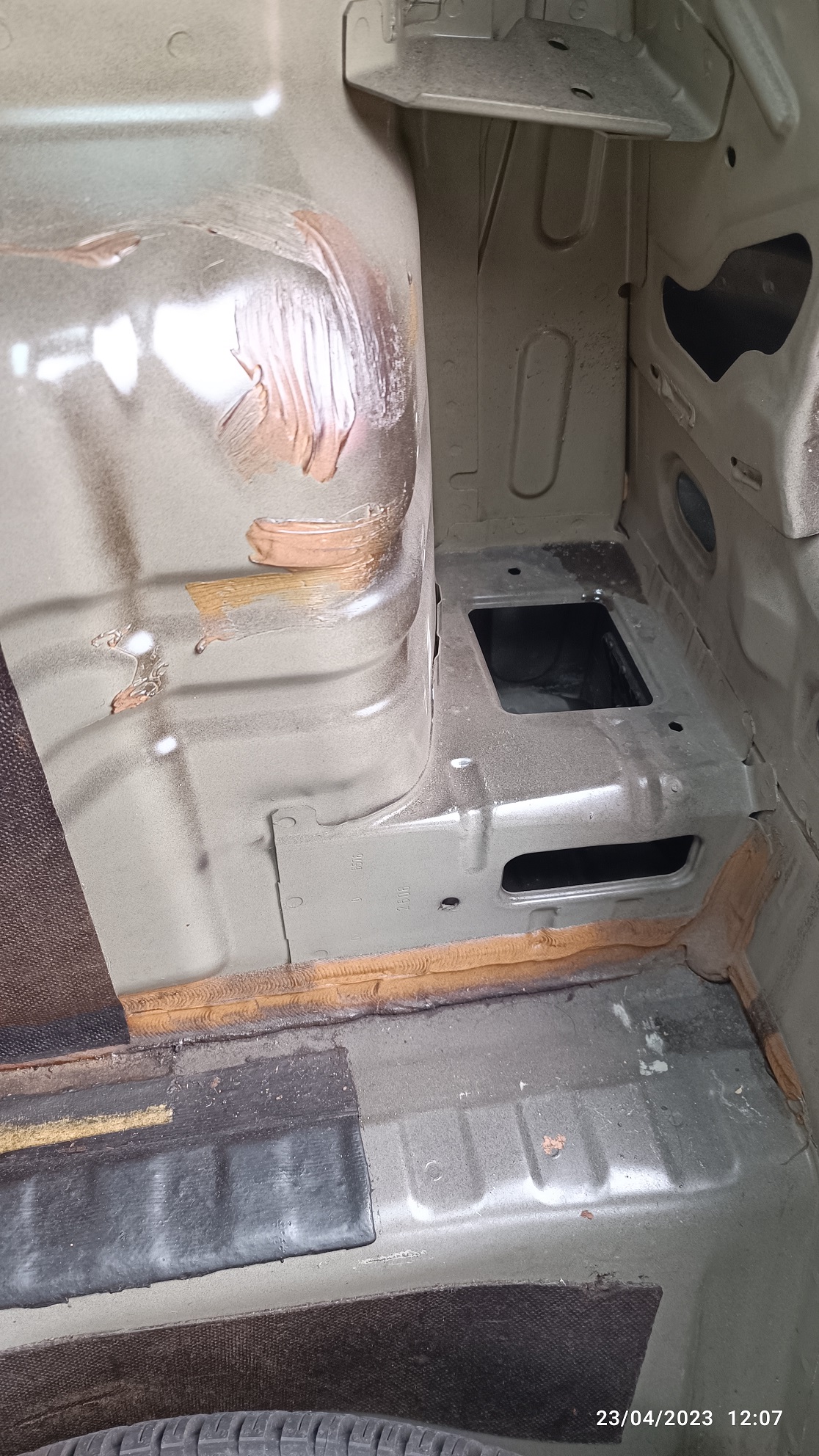

So I've taken the rear interior apart and can't find any obvious signs of water ingress. Areas covered by panels/carpet are dusty, have cobwebs and other dirt found in a 17 year old car.

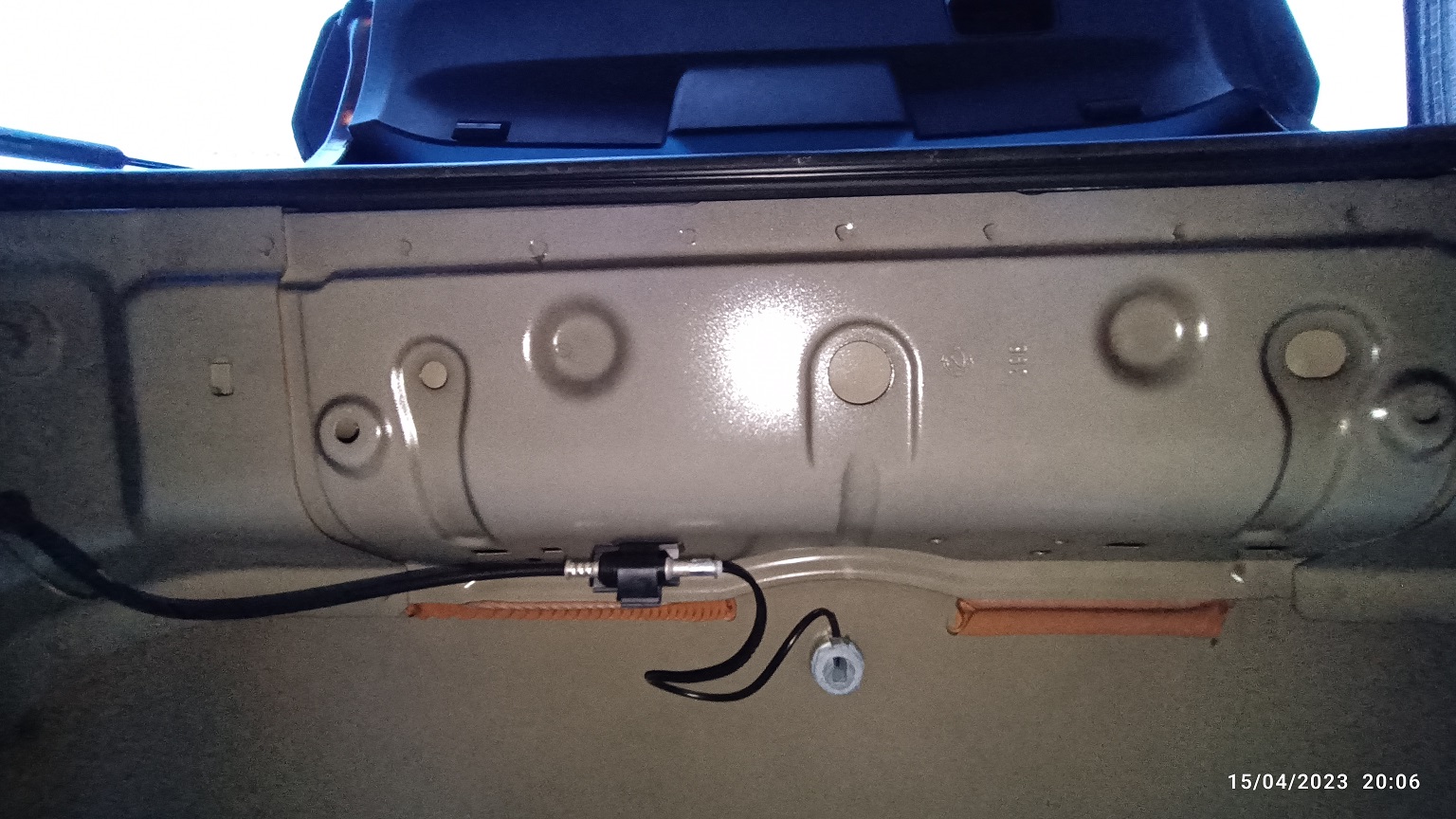

So this is the boot area which I usually first spot is wet and the boot liner is wet underneath and if raining for a long time the spare wheel well turns into a pond;
Initially I thought it was the perished aerial base rubber but having removed the headliner the aerial base mount is pretty much factory looking with no sign of water/liquid on the roof liner;
Sides are as expected - look like when they come out of the factory with some ageing (one of the black pads is a bit curled up) and coating of dirt;
IMG_20230422_163327.jpgIMG_20230422_170236.jpgIMG_20230422_170248.jpgIMG_20230422_170306.jpgIMG_20230422_170423.jpgIMG_20230422_170439.jpg

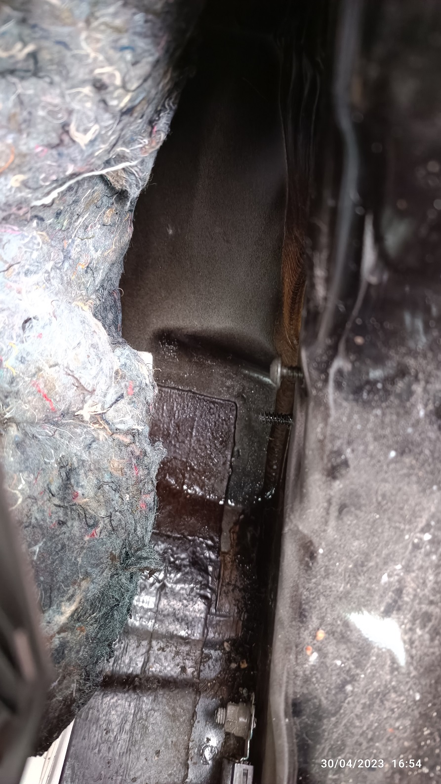

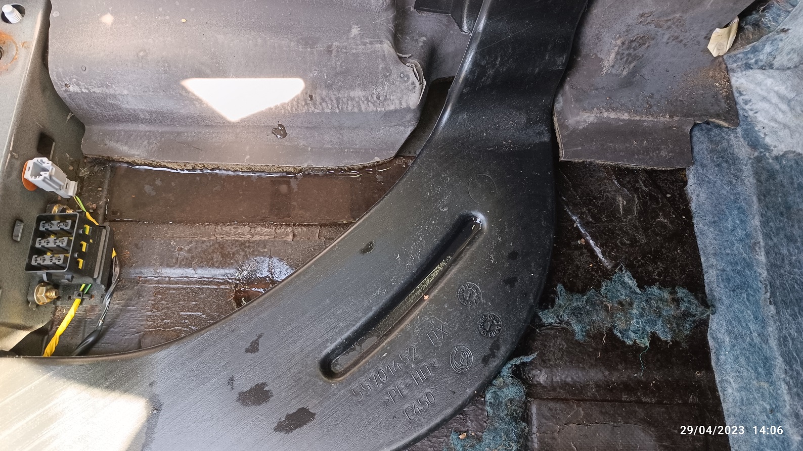

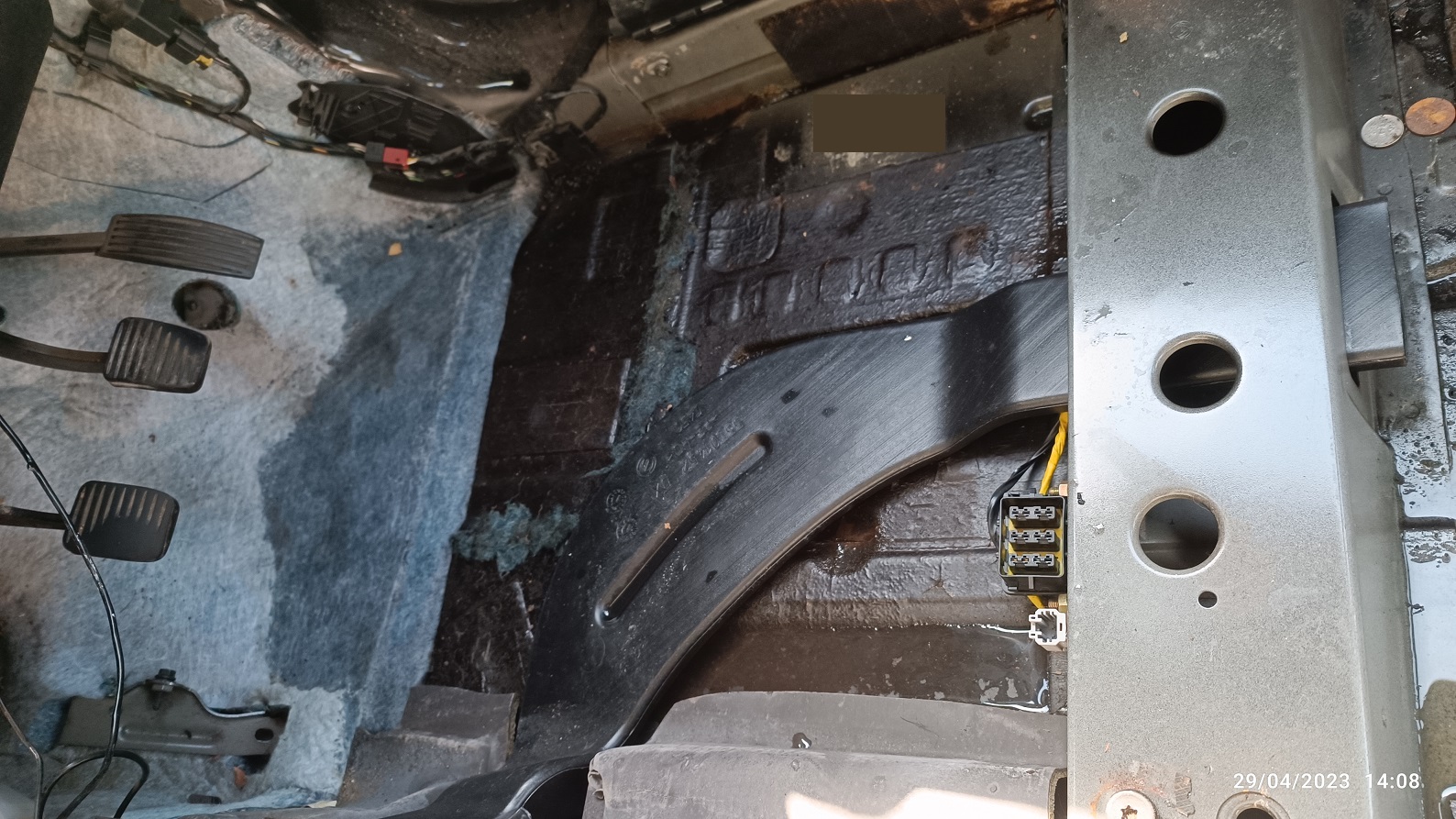

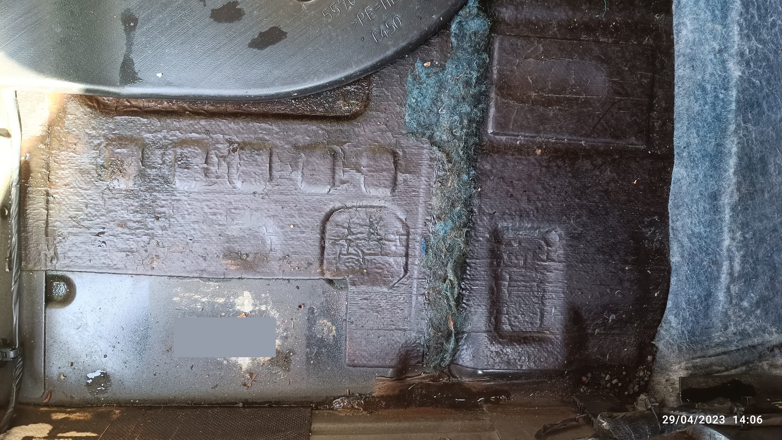

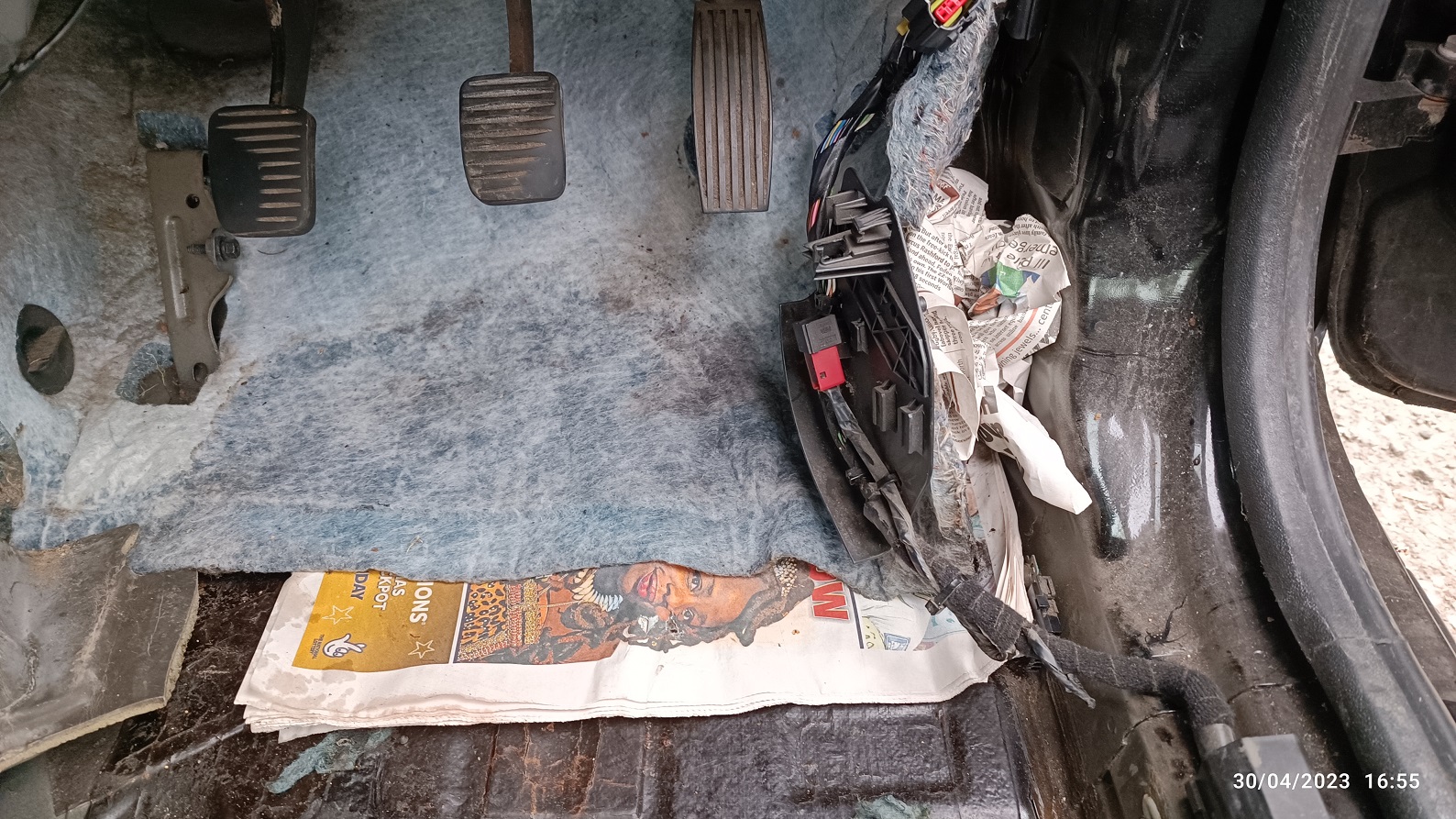

I looked under the carpet behind the driver (where the earlier puddle pic) and there is still old water under there with 25p :D;
I am aiming to remove the front seats, center console and main carpet tomorrow.
I did find the metal plate the ODBC port is mounted to rusted, which probably indicates moisture/leak;
If it is leaking at the front, that might explain the water in the footwell behind the driver - but water in the rear and getting into the spare wheel well?
You can view other dismantling pictures HERE

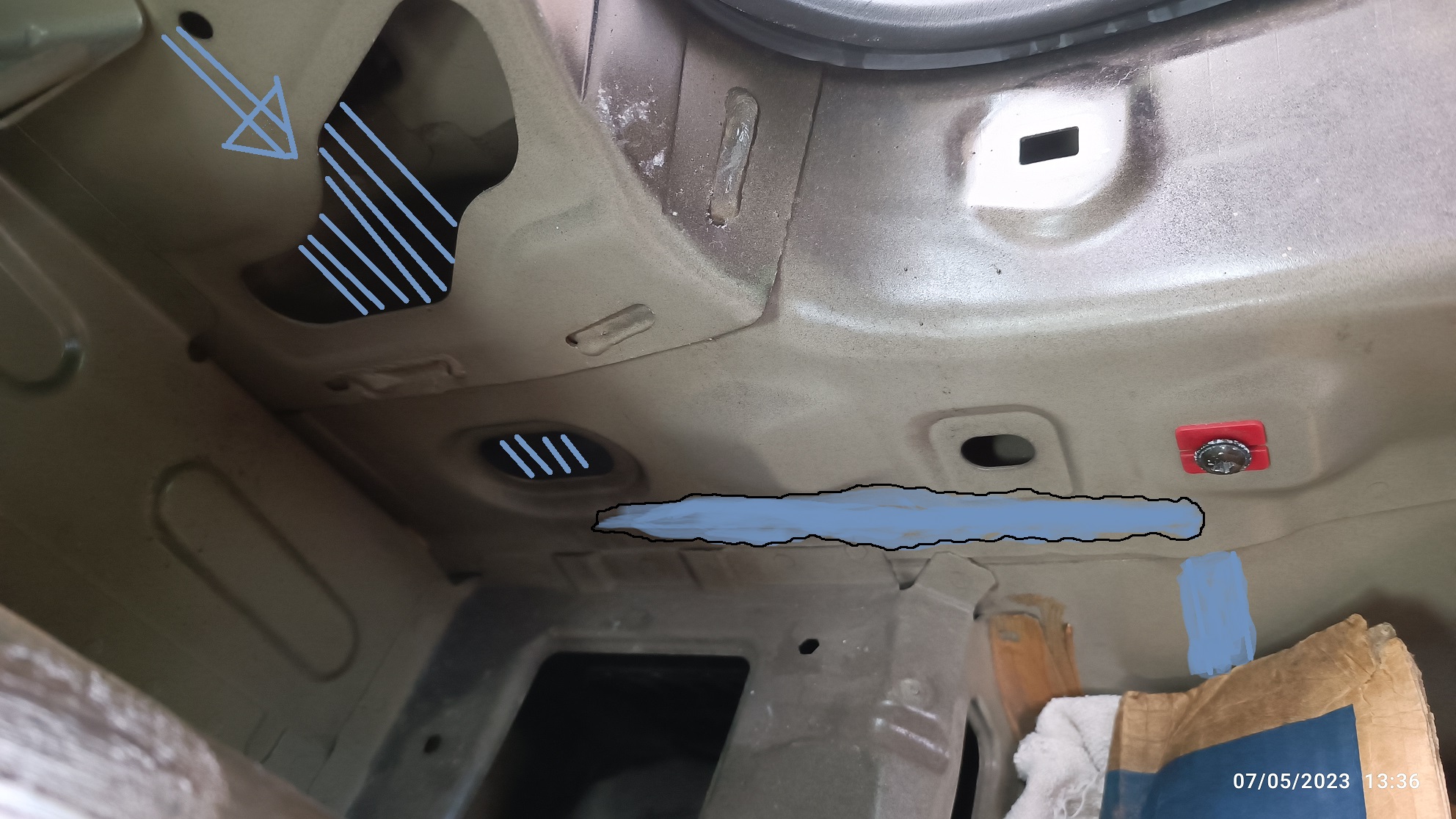

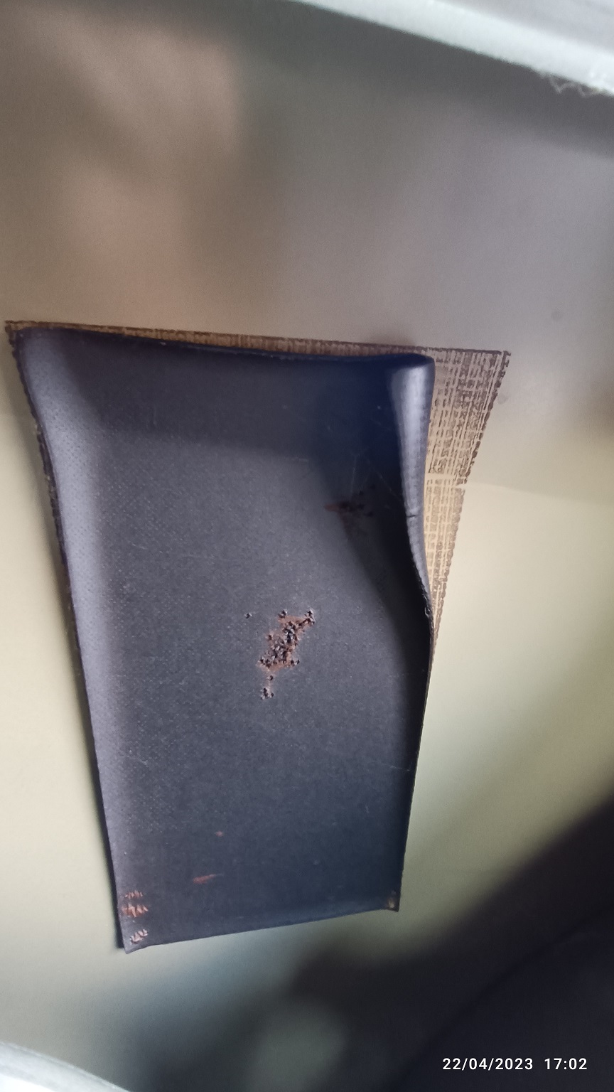

Whow! You have certainly been busy, lovely load of photos.

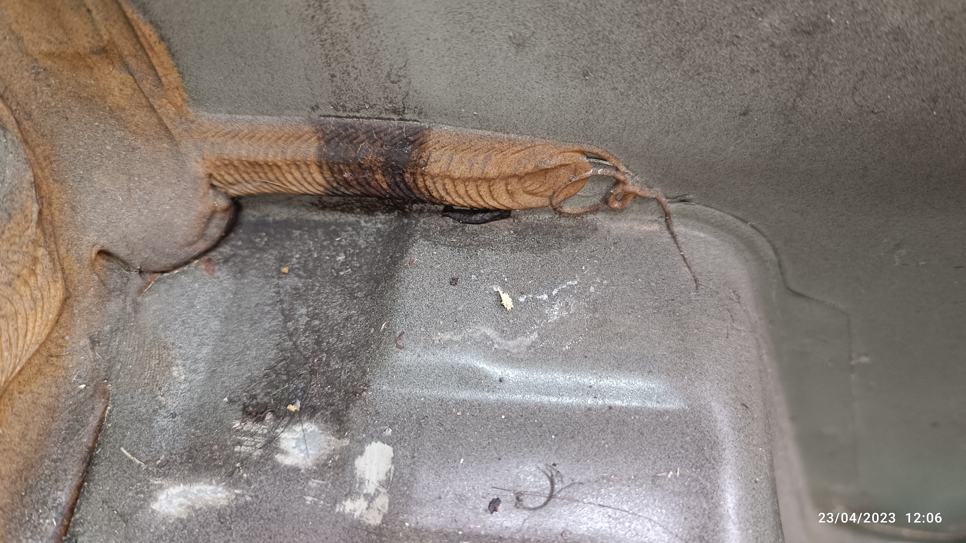

The only one I could see slightly suspicious was in your first photo, below the square red plug there looks like a slight stain mark from the rear boot closure panel down and onto the O/S ? boot floor above the wheel well.
May not be relevant but I recall Ford Escorts used to have problems with the rubber gasket behind the rear lamp clusters allowing water in.
Possibly try laying tissue paper around and or some compound that changes colour with water, prior to rain or hose pipe use (we are in a hose pipe ban area now) to see if anything shows up.

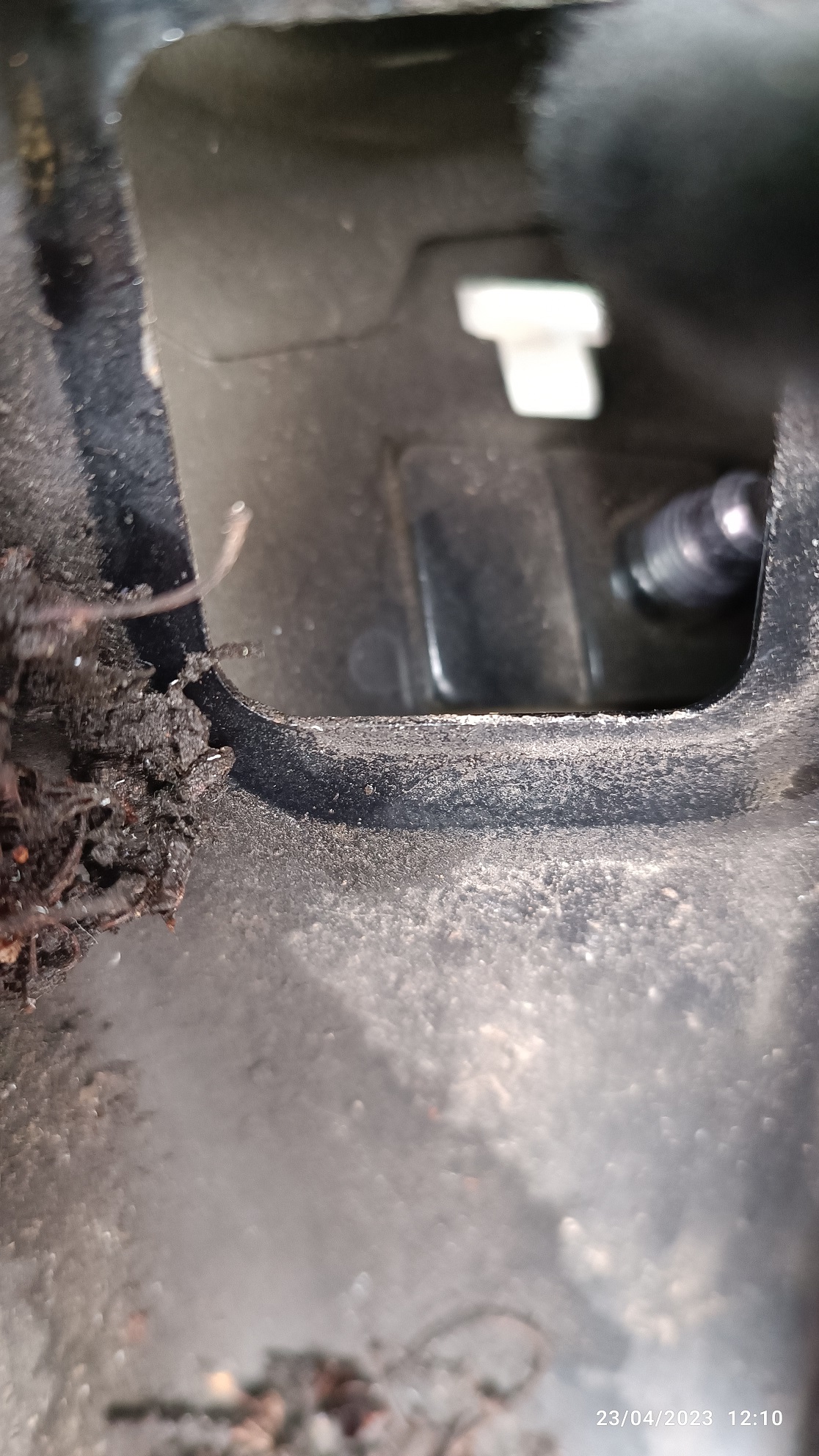

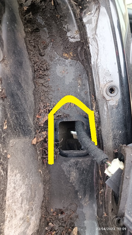

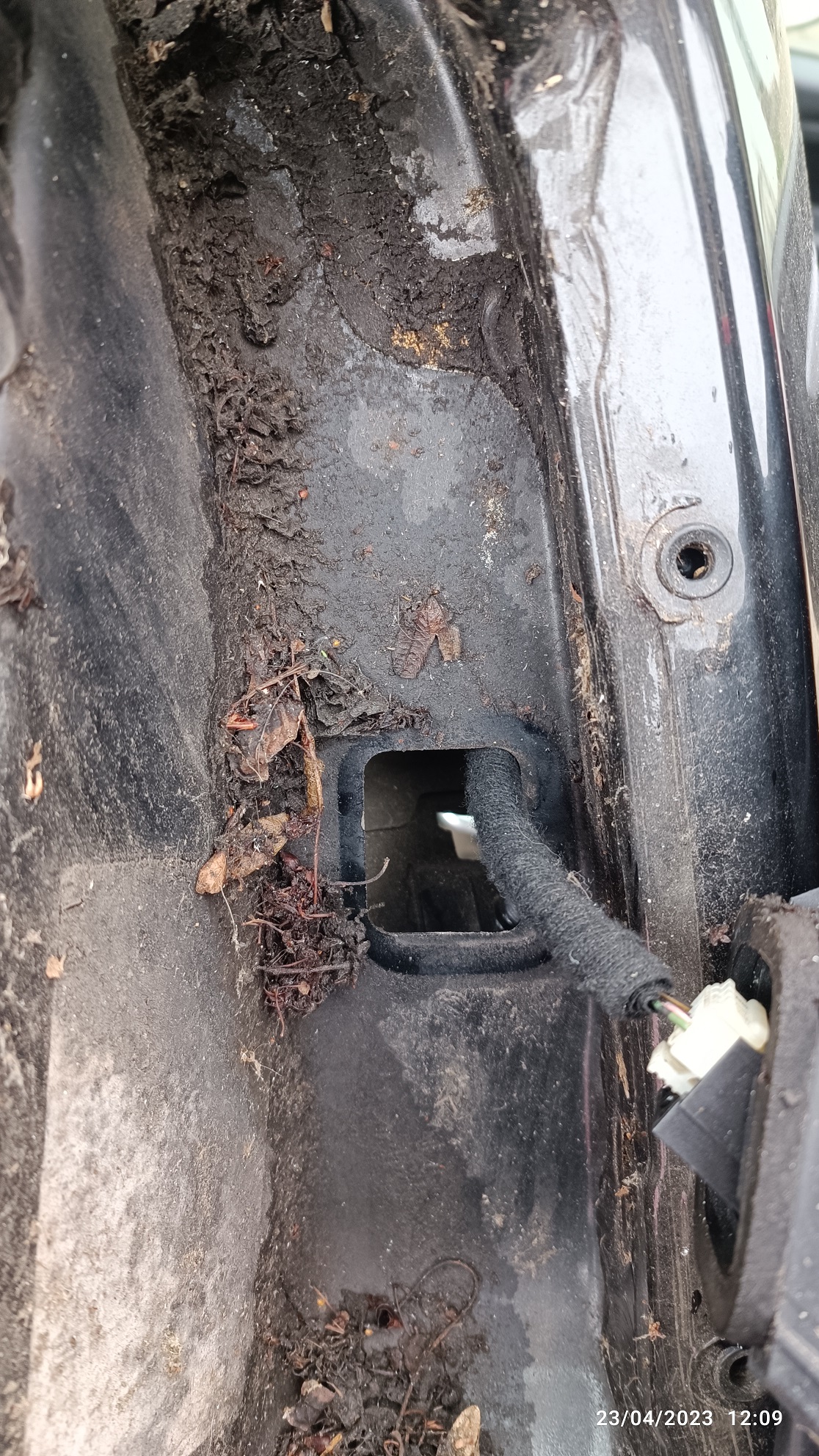

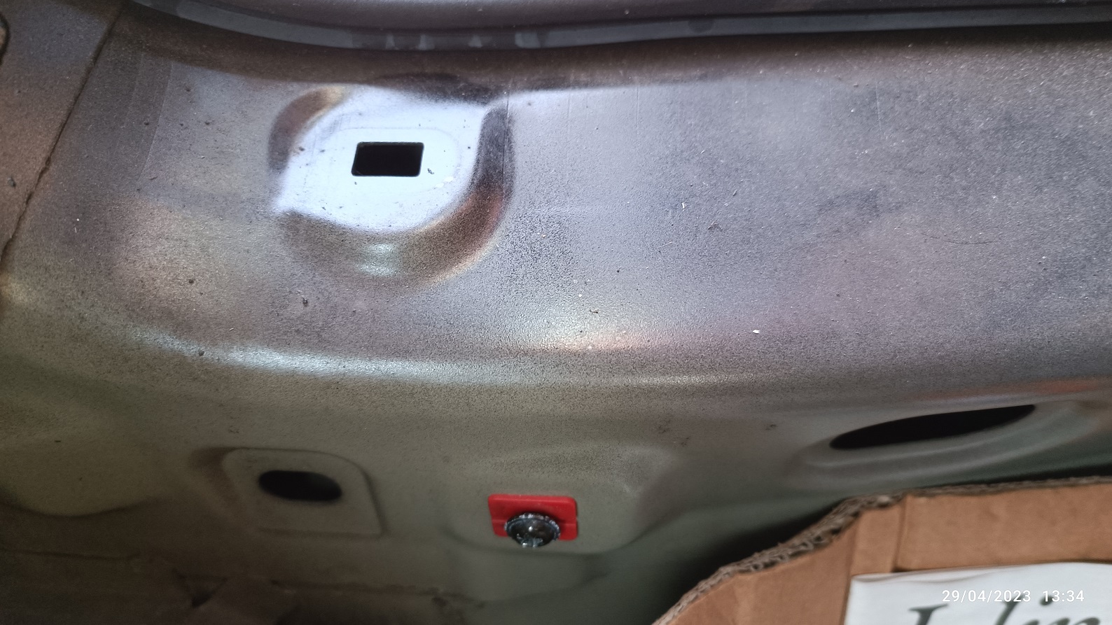

Good spot! You have passed the test. I think I just dismissed it as it was dirt/dust like everywhere else and I was expecting it to be a 'clean' path/run where the water was flowing. I guess this would be the case for a steady flow but if only a droplet at a time or trickle then that wouldn't move anything but just make it moist.
So this suspicious black line is actually a big clue to the current suspected source - you'll see a little further on.

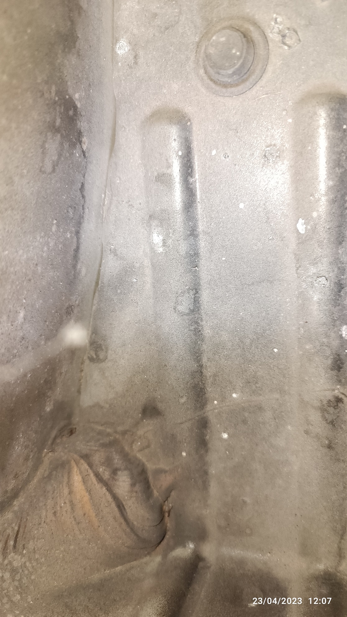

The overnight weather has helped us today 🌧️
This morning I was greeted by this;
On closer inspection of the dark line and poking it, (it was moist and the black was dirt like soil) the source seems to be this join/seam;

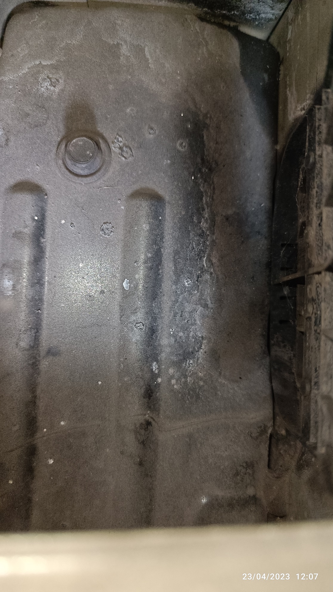

Looking at the tailgate lip it is clear from any similar marks - just has a uniform, coating of little black dots which must be overspray from painting (car is black).
Looking into the void between wheel arch and rear corner, there is a little puddle of water;
And above there is the location of the rear light cluster which is looking like this today;
You can see around the square hole the 'cleanish' area where decent contact was being made but at the top there is no satisfactory 'clean' line like there should be. Looking into the hole doesn't reveal much but the seatbelt unit mount - so water must be dripping/flowing down into the corner bit and some the other way to that join and both then rejoin and flow down into passenger footwell as per picture above. I guess it also depends if car is parked at an angle;
So this looks like the source of the leak as there is black dirt/soil type material which feels/looks the same as what has been trickling out of that join creating the black line.
This makes me so mad as it is essentially on the exterior of the car in an area (channel) where you expect a lot of water will be flowing in long/heavy rainfall.
Why doesn't this have some sort of waterproof rubber connector or cable pass through? Unless pressured for cost-savings which designer who calls themselves a professional would come up with something like this and consider it satisfactory. :mad:

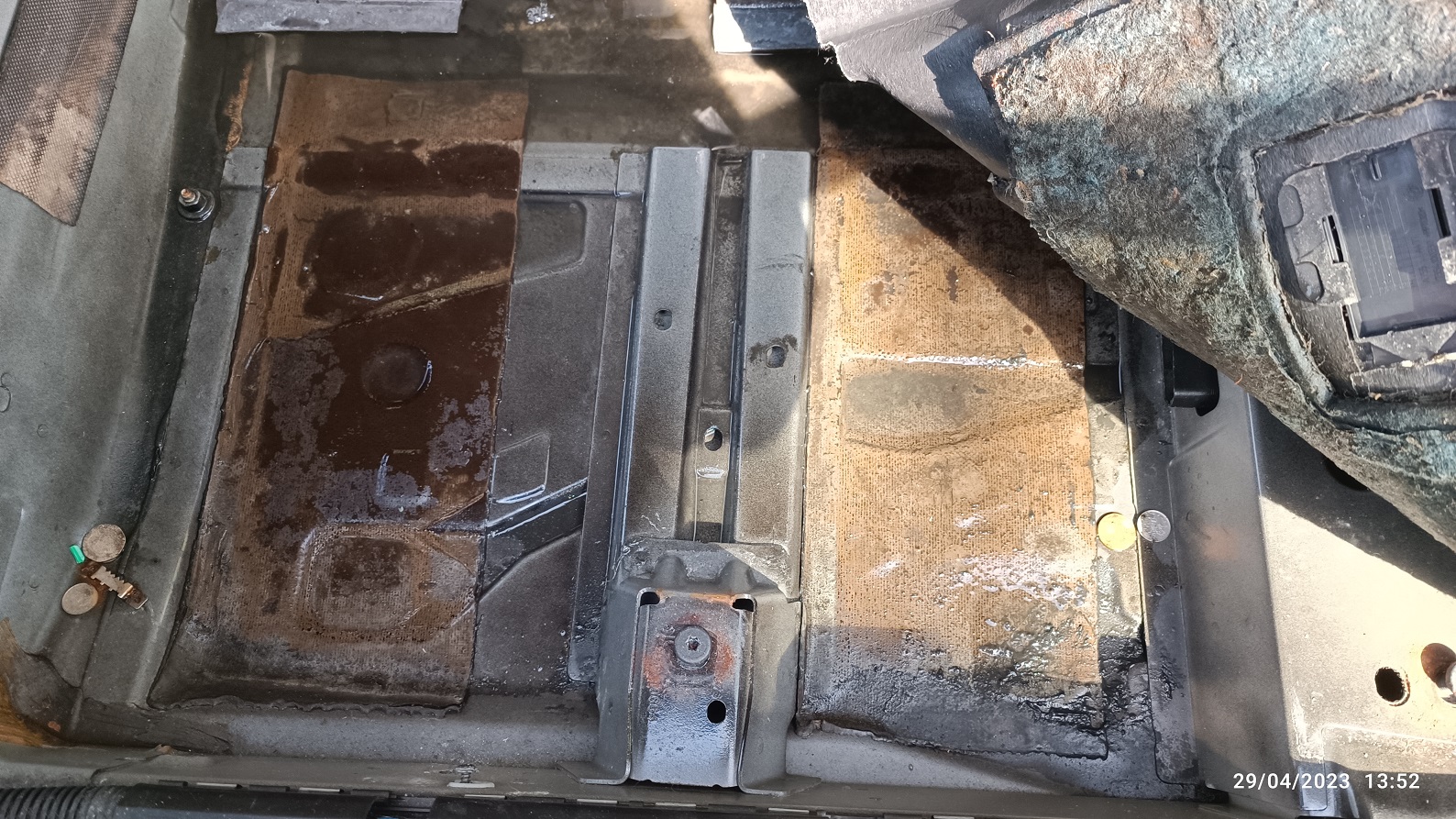

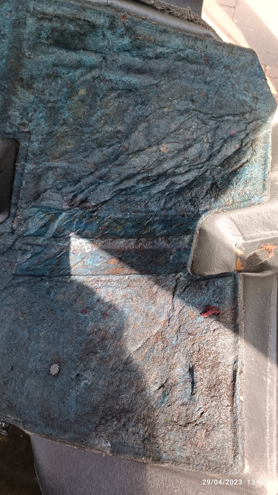

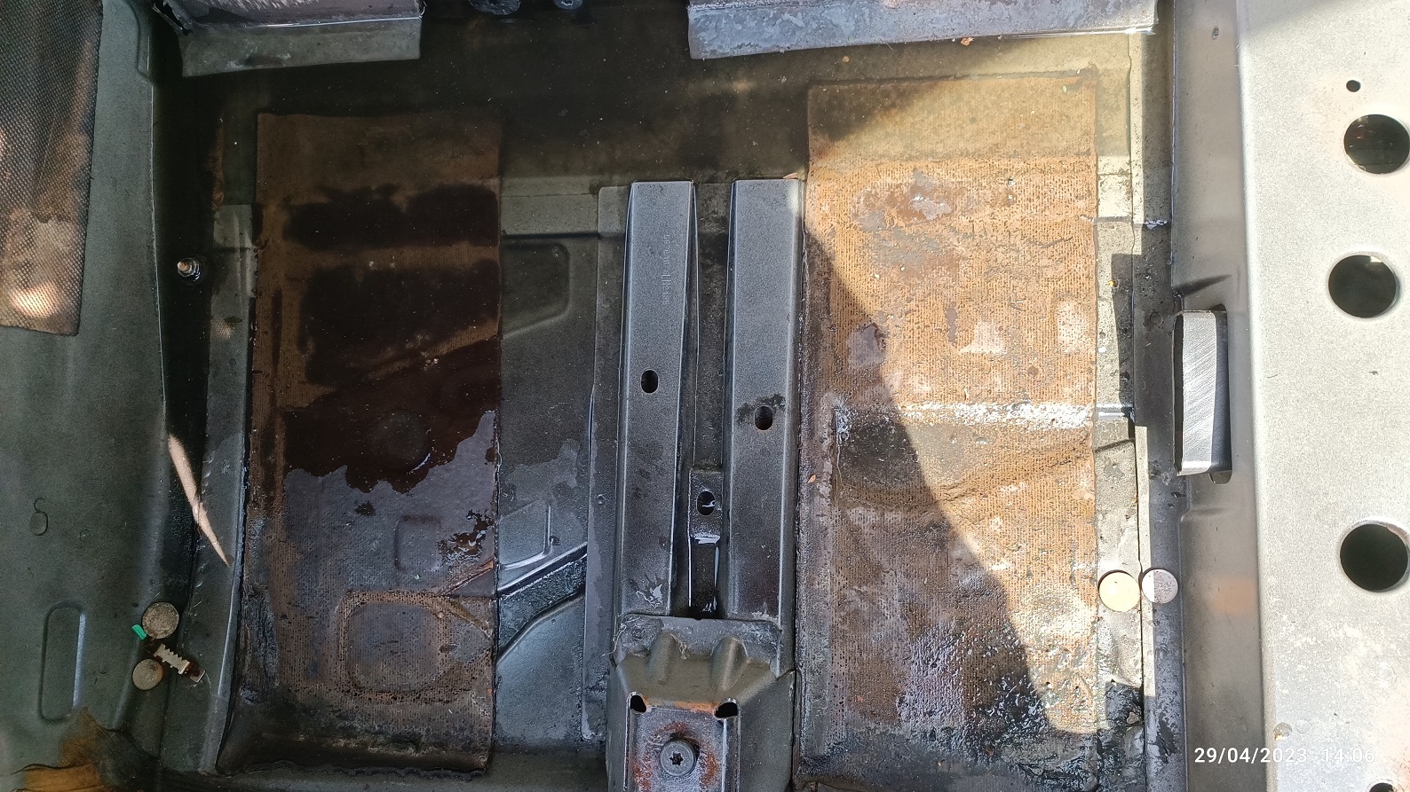

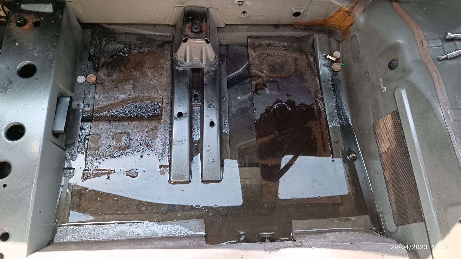

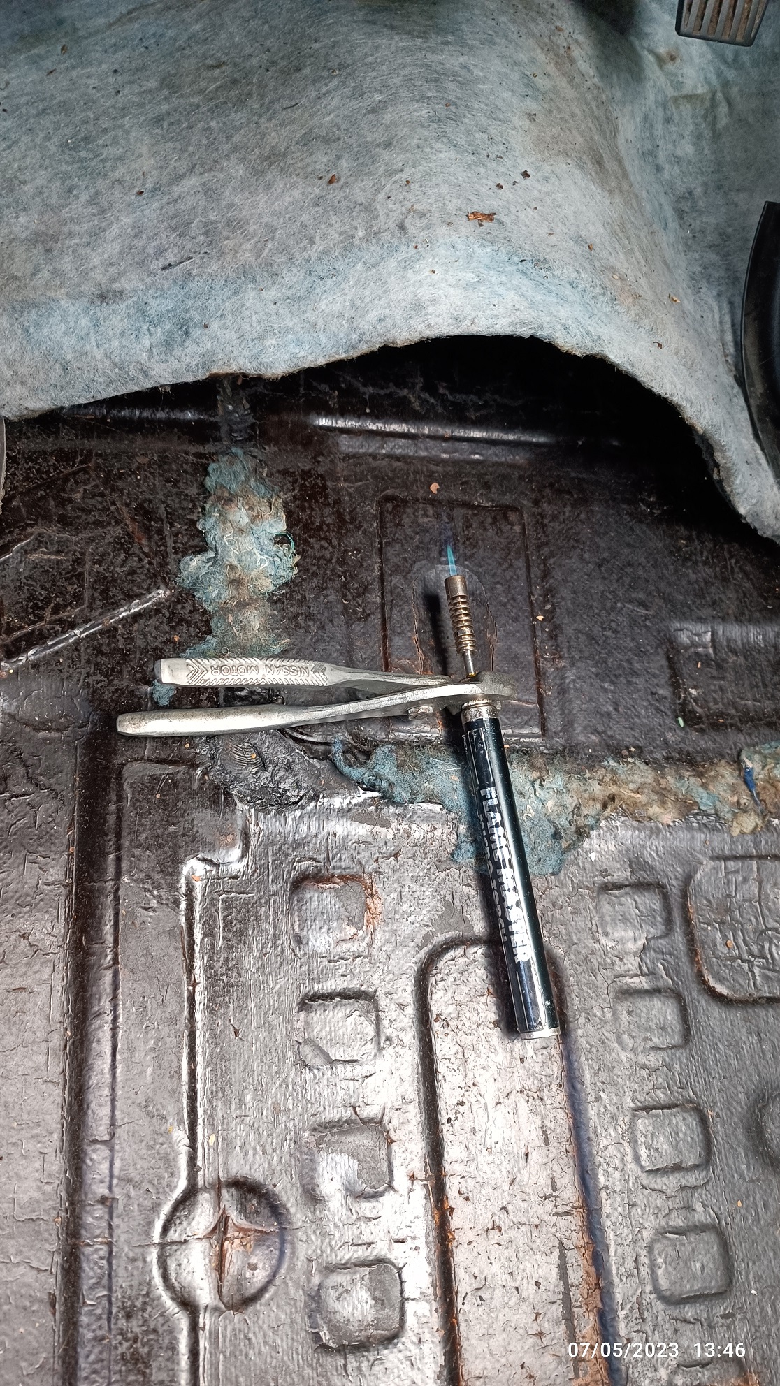

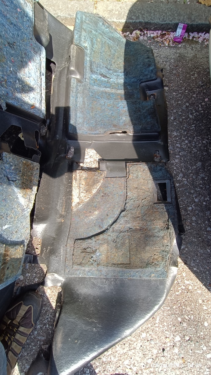

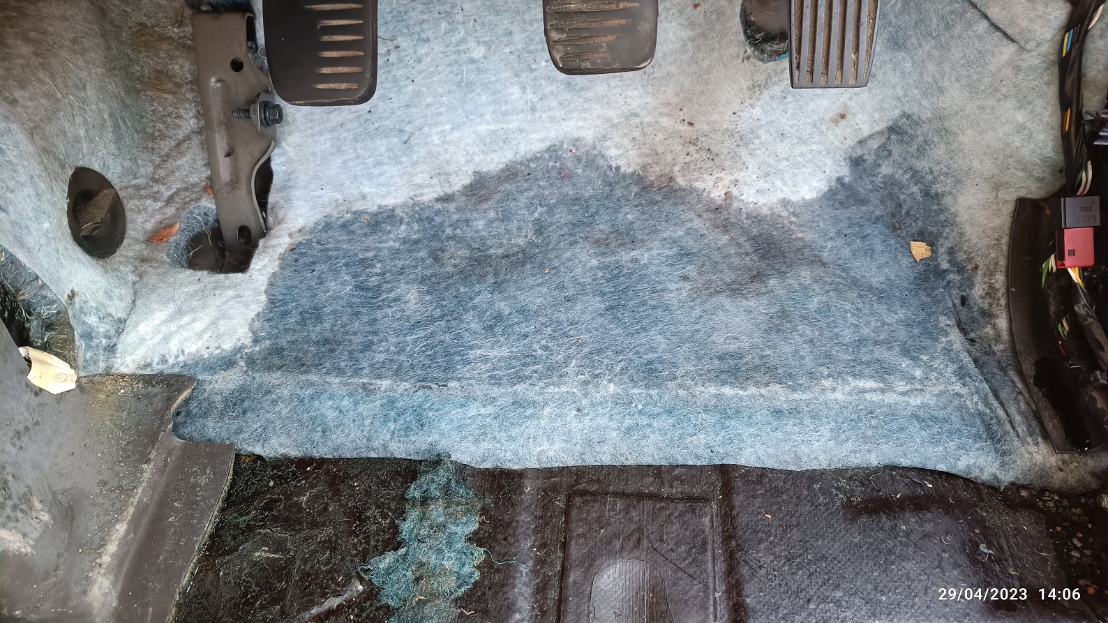

I ran out of time getting the carpet out as once I had the centre console out I found out it is 'locked in' by support struts and parts of the air blower channels. I didn't have scissors/knife with me to cut it for easy removal so have left it.
I did lift the drivers side up and it's also wet underneath and unpleasant smelling - the noise dampening material is REALLY thick and will take ages to dry out.
Pics from today are HERE

Anyway, weekend 3 of the Grande Punto stripdown is here.....:cool:
First pic is one I forgot last time of the top of the boot tail gate - the area at the top of the suspicious 'black line/trail' is clean (apart from paint splatter) so not coming in through tailgate/tailgate seal;
After removing seats, cutting the front central parts of the carpet 'trapped-in' by metal struts & blower components and some more tugging in various directions - it finally gives in and I am able to raise up the drivers side to reveal this sight;
Lifting it all the way to reveal the horror which hides beneath;
I had to leave it at an angle for 20 minutes for the draining water to turn to a trickle and trickle to turn into droplets which then turned back into a trickle each time I squeezed;
I heaved the carpet out which was still much heavier on the drivers side;
Then back to inspect the drivers side lake;
I guess these little holes allowed the rear leak all the was into the drivers footwell;
The passenger side looks how I wish the drivers side did;
The carpet has been in front of a radiator for about 48 hours and now seems pretty dry but the drivers side now feels more rigid than the passenger side.
The 'foam' covering over the central tunnel also seems to have largely dried out with a combination of newspaper underneath and squeezing.
Half the drivers footwell soundproofing is still firmly held-in-place so I'm going to avoid taking it out and attempt to dry it out in situ using a combination of newspaper, cloth, kitchen roll, applying pressure to get the water out (by foot and I might try a rolling pin) and something else which I'm open to suggestions?
This weekends gory pics HERE
So for my temporary 'fix' I thinking of applying some silicone beads to divert water flow away from the suspected point of ingress and also away from the 'trickle path' to the drivers side rear footwell.
At the drivers side light cluster wiring loom 'body hole' I will apply silicone in the following shape to divert any water down the sides of the loom opening;
Along the 'trickle path' I will apply similar silicone to divert any water into the spare wheel well to prevent it making its was into the drivers side rear footwell again;
While this may mean I still have a wet boot carpet and a spare wheel 'well' (with water in ;)) - that's far easier to rectify than removing & drying the main carpet :D Fingers crossed for awarm & dry 2023!

Unfortunately I can't get a mains power source and Saturdays weather wasn't the glorious sunshine I was hoping for. Multiple newspapers did soak up a lot a water over the week and at the weekend it was still 'damp-to-the-touch' (and squeeze) in places. So I decided to resort to a primitive approach;
The trusty 'Flame Master', some toolkit edition Nissan pliers, a bottle of water on standby and sitting there for about an hour with the door open.
With just a single singe incident it did remain nice and warm under there and doing the squeeze test on Monday showed very favorable results.
I think we are at a satisfactory point with this piece and just a piece on the middle tunnel with synthetic back is leaving a patch of condensation on the metal behind it. I have treated it to some newspaper and will check/change it over the week.

So the rainy weekend has added to the case against the crappy light cluster wiring loom access non-seal. I put a couple of cloths down along the leak 'path' so no water gets far inside again an they did the trick. Were wet but no water made it near the driver rear footwell.
There was water in the box sections behind the rear wheel arch which supports your 'black line' water ingress - water comes off the roof into the rear tailgate channel and flows down onto the crappy non-seal and drips/trickles down the inner of the box section onto the flat ledge which may be well welded/joined. When enough water has pooled/accumulated it finds the opening under the red screw holder to continue its travels in the interior;
Still so disappointed and annoyed at the design/quality of the rear light cluster wiring loom through hole. :mad:
